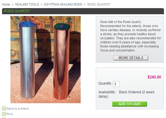

Mike Kranzler Posted September 29, 2011 Share Posted September 29, 2011 Yes I do. They still show up as available in the Category list because you're set in your back office to allow orders when out of stock, but if you open the actual product, it looks fine: And keep in mind, I only updated this one product to make sure it was working properly. The rest will be up to you. Let me know if this is any different on your end. -Mike Link to comment Share on other sites More sharing options...
Xtaz411 Posted September 29, 2011 Share Posted September 29, 2011 Oh sorry yes I see. Thank you it works. It would be great if the message could also be in the category display because if people do an add to cart from there they will never see the message. Any way to do that? Thank you for all your help Link to comment Share on other sites More sharing options...
