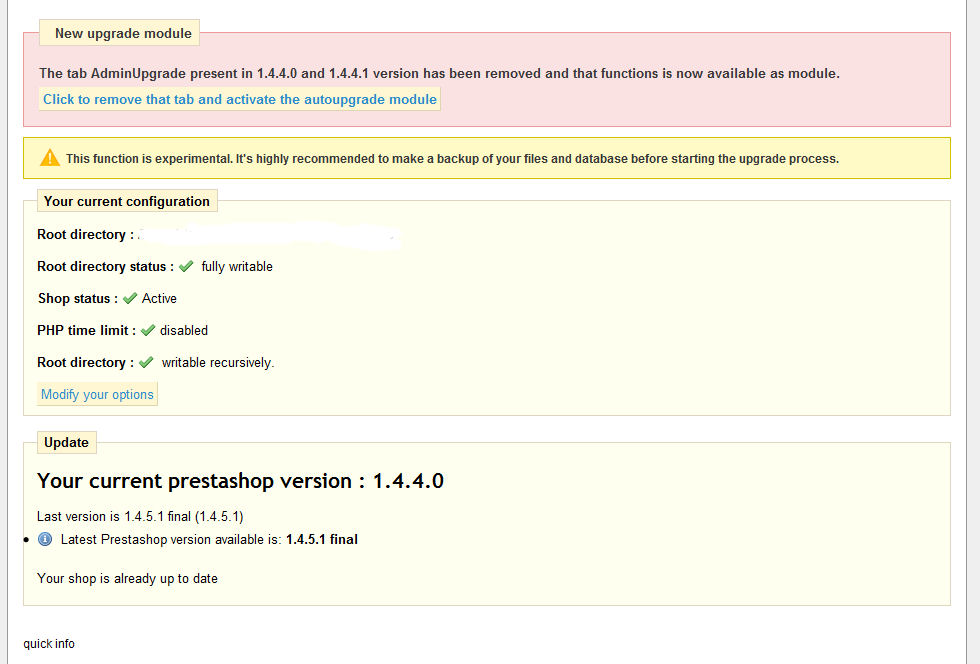

Rhapsody Posted August 26, 2011 Share Posted August 26, 2011 I ended up doing the upgrade from 1.4.4.0 to 1.4.4.1 the old manual method because I couldn't get the upgrade tab in the BO to function. Did anyone get it to work? Edit: This was corrected by updates to Prestashop and files I loaded from the SVN version. There are a number of people who had issues, and ultimately the upgrade feature was updated in the final release of 1.4.4.1. I was able to use the upgrade feature going from 1.4.4.1 to 1.4.5.1 Link to comment Share on other sites More sharing options...

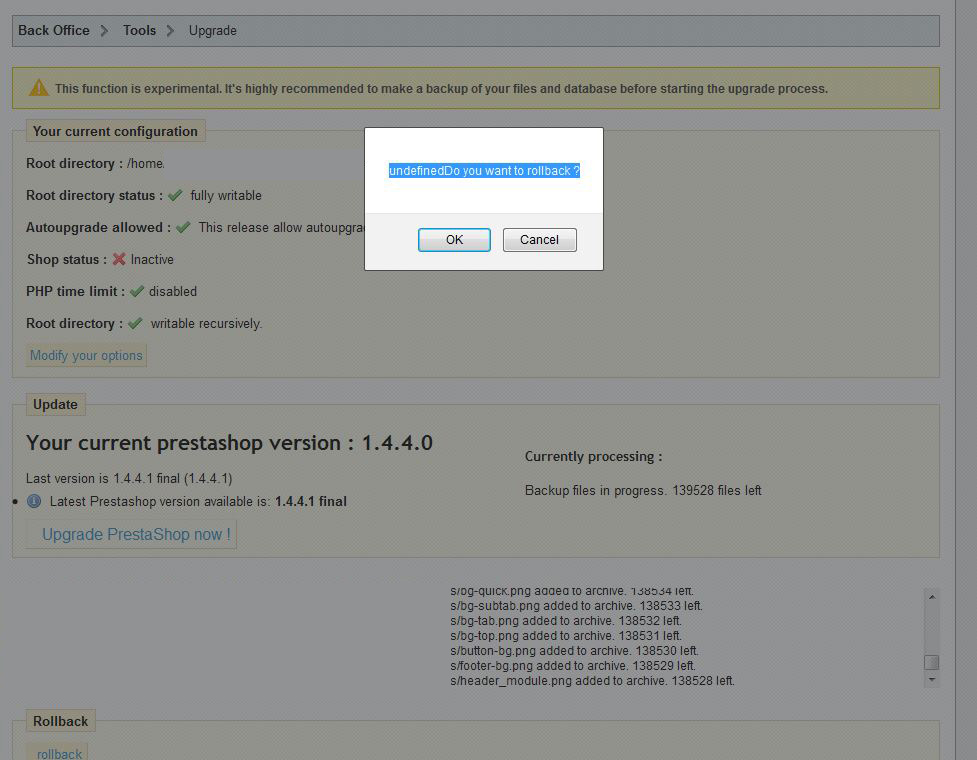

FutureLED Posted August 27, 2011 Share Posted August 27, 2011 The process appears to be trying to backup the complete root folder on the server, I have several sites in the root, Is there is any way to skip selected folders?? Link to comment Share on other sites More sharing options...

Rhapsody Posted August 27, 2011 Author Share Posted August 27, 2011 Rhapsody, if you don't have the tab (Tools > Upgrade), maybe it's a bug from a previous version. Does the file "/admin/tabs/AdminUpgrade.php" exists ? Yes I have the tab and the file. It is just that when I tried the upgrade using the tab I get the message: Currently processing : I'm waiting for your command, sir Link to comment Share on other sites More sharing options...

JohnADK Posted October 21, 2011 Share Posted October 21, 2011 Steps that must pass in order to upgrade successfully: 1. Replace&upgrade AdminUpgrade.php from prestashop 1.4.4.1 (latest version) 2. Perform the upgrade process 3. Note the description of the upgrade process, if the step download process and extract prestashop completed (while waiting for the process entirely complete), do the editing AdminUpgrade.php on: / ps_admin / autoupgrade / latest / prestashop / ps_admin / tabs / AdminUpgrade.php as done in point 1 , with the filemanager or SmartFTP. 4. Allow the upgrade process done completely by prestashop, pending the outcome. Kudos to adjayabdg and Michaël Marinetti!! After reading the thread, I went with Michaël's comment instructions for AdminUpgrade.php based on the above summary written by adjayabdg and the AutoUpgrade worked perfectly!! I am now a happy web shop owner having upgraded from 1.4.4.0 to 1.4.5.1 without hitches. It is so fantastic that upgrading is now super easy. I am delighted. Thanks for taking the time to solve this little upgrade issue. Now I don't have to worry so much about the time involved in upgrading my shop. Thanks to all who have worked to add this AutoUpgrade feature. It is really a great help!!! Link to comment Share on other sites More sharing options...
JohnADK Posted October 21, 2011 Share Posted October 21, 2011 Hi Rhapsody, In answer to your original question: Yes, I have successfully upgraded from 1.4.4.0 to 1.4.5.1 after following advice of Michaël Marinetti and adjayabdg. AutoUpgrade worked perfectly (with the amendments these two persons made in your thread). Perhaps you can mark your post as [solved]? This will point others in the right direction. Link to comment Share on other sites More sharing options...

koh0222 Posted December 11, 2011 Share Posted December 11, 2011 Steps that must pass in order to upgrade successfully: 1. Replace&upgrade AdminUpgrade.php from prestashop 1.4.4.1 (latest version) 2. Perform the upgrade process 3. Note the description of the upgrade process, if the step download process and extract prestashop completed (while waiting for the process entirely complete), do the editing AdminUpgrade.php on: / ps_admin / autoupgrade / latest / prestashop / ps_admin / tabs / AdminUpgrade.php as done in point 1 , with the filemanager or SmartFTP. 4. Allow the upgrade process done completely by prestashop, pending the outcome. Hi, i do not understand the step 1. How do i Replace&upgrade AdminUpgrade.php and where can i get the file? Pls help... Thks... Link to comment Share on other sites More sharing options...
Armando Salvador Posted June 4, 2012 Share Posted June 4, 2012 (edited) Hello, this problem was happened to me too. Looks the apache error file on your server. In my case, the error appeared was in class cache. In order to update what you can do is to disable the cache, smarty first, and Cache (where it says memcache). When you disable these two points can update without problems. Here the same explanation http://forge.prestas...9#comment-54459 I hope this helps! Edited June 4, 2012 by cokarmando (see edit history) Link to comment Share on other sites More sharing options...
