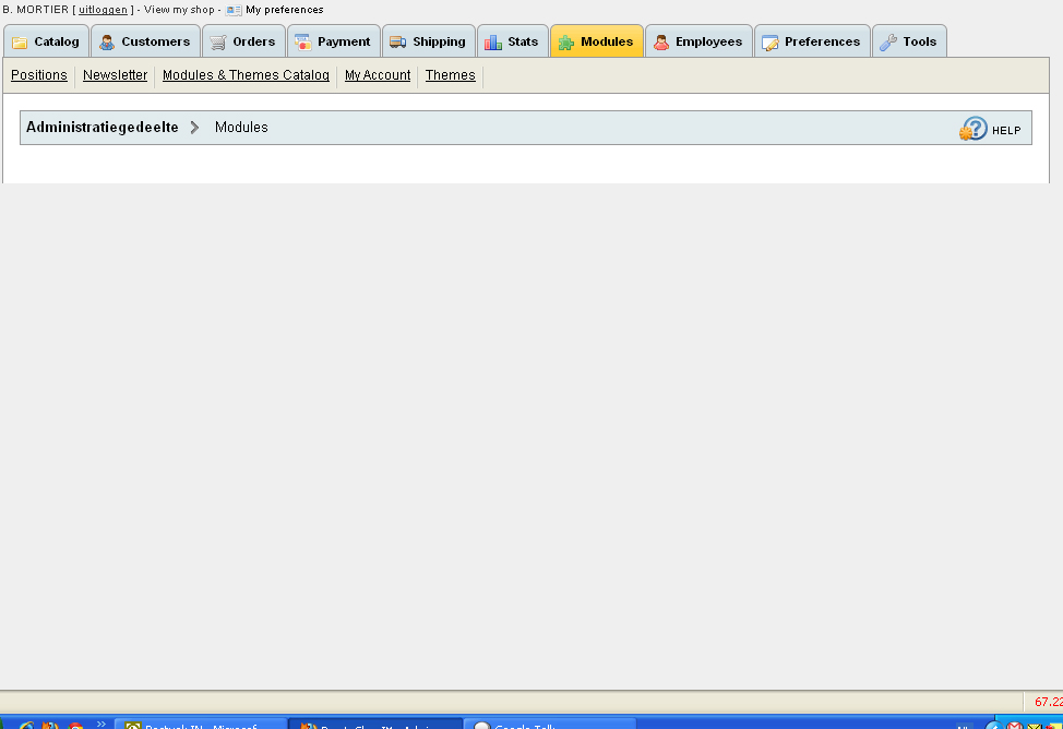

fideel Posted August 24, 2011 Share Posted August 24, 2011 Hello, just updated tot 1.4.4.0 Everything works almost fine. Only thing: Problem 1: when in BO, clicking on "Modules" i can't see the modules to change anything. Check picture. PS: same problem with the 'payment' tab Problem 2: Stockproblem. All my articles seems to be available in a categorielist ( but in backoffice some of them are having 0 stock ) So, why does Prestashop tell my clients that i have it available, when it's not in stock? When clicking on the article itself, you can see the correct deliverytime. So when in stock 2 days, when not in stock 2-3 weeks or so, so there it is correct? How to change that? Is there anyone out there who can help me? I can't add paypal, can't change modules because I can't enter the screen? Thx in Advance How can i get them back? Warmest Regards, Link to comment Share on other sites More sharing options...
Rhobur Posted August 25, 2011 Share Posted August 25, 2011 The fix for the problem 1 is to increase the memory amount on the hosting server; if you're using your own you cand do it yourself otherwise ask the provider. Link to comment Share on other sites More sharing options...
