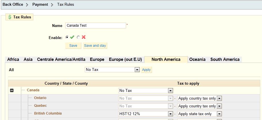

I can not save tax rules. Works fine for a state in the USA
Steps to recreate problem
Click Tax Tab
Create a Tax HST12 12% Enable Save
Click Tax Rules
Select Canada
Select British Columbia
Select State Only
Select HST12
Save
Reload you will see it did not save the info
But doing the same procedure for a US state everything is fine.
Tested on 1.4.3 and 1.4.4 same problem
Click Tax Tab
Create a Tax HST12 12% Enable Save <--- Just like you suggested.
Click Tax Rules
Select Canada
Select State Only
Select HST12
Save
Now look at it again. It did not save it.
This problem is specific to Canada, the same procedure for 'US' and state seems to work.

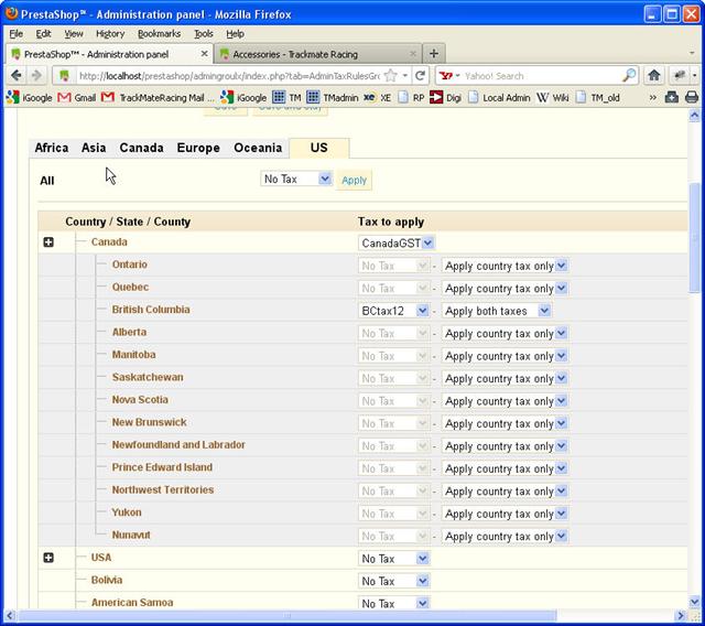

I have Canada as a tab and also Canada under US
All this time I've been trying to modify rules under the Canada tab but.....
It seems to work if I modify Canada under US but not under Canada
Why does Canada appear in two different places?
