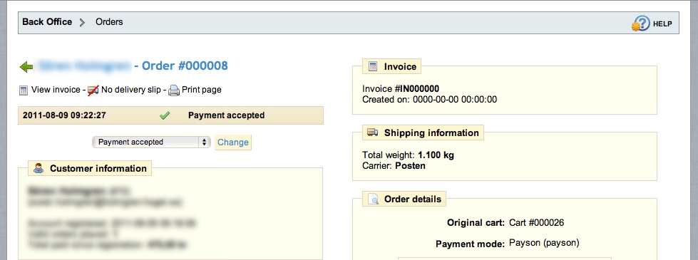

m-tias Posted August 10, 2011 Share Posted August 10, 2011 Hi! As the topic says, no invoice number or date are registered for the orders in the shop. Does anyone have any idea of where this could go wrong? Thanks, Mattias Link to comment Share on other sites More sharing options...

m-tias Posted December 5, 2011 Author Share Posted December 5, 2011 Never had the time to update to 1.4.4, so I don't know if that would have solved the problem, but today I updated to 1.4.6.2 and the problem seems to be gone. Link to comment Share on other sites More sharing options...

ccollins Posted March 28, 2012 Share Posted March 28, 2012 I have the same issue. Why is there no definitive answer to this problem anywhere. In the bug tracker there is reference to making the following change to the database but everyone who tries reports it does not work. Then some Prestashop person logs into thier sites and reports it fixed without telling anyone what they did. Why would you do that? ALTER TABLE `ps_lang` ADD `date_format_lite` char(32) NOT NULL DEFAULT 'Y-m-d' AFTER language_code; ALTER TABLE `ps_lang` ADD `date_format_full` char(32) NOT NULL DEFAULT 'Y-m-d H:i:s' AFTER date_format_lite; UPDATE `ps_lang` SET `date_format_lite` = 'd/m/Y' WHERE `iso_code` IN ('fr', 'es', 'it'); UPDATE `ps_lang` SET `date_format_full` = 'd/m/Y H:i:s' WHERE `iso_code` IN ('fr', 'es', 'it'); UPDATE `ps_lang` SET `date_format_lite` = 'd.m.Y' WHERE `iso_code` = 'de'; UPDATE `ps_lang` SET `date_format_full` = 'd.m.Y H:i:s' WHERE `iso_code` = 'de'; UPDATE `ps_lang` SET `date_format_lite` = 'm/d/Y' WHERE `iso_code` = 'en'; UPDATE `ps_lang` SET `date_format_full` = 'm/d/Y H:i:s' WHERE `iso_code` = 'en'; Anyway this problem is not solved. I don't want to risk damaging my DB unless someone can verify this is an appropriate fix. Thanks! Link to comment Share on other sites More sharing options...
