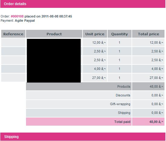

Troy Posted August 8, 2011 Share Posted August 8, 2011 Hello all. Instead of the Euro symbol (€), some gibberish words ( € )were shown on the invoice (attachment is below). How do I rectify it? Thanks My version is 1.3.4 Link to comment Share on other sites More sharing options...
mohsart Posted August 8, 2011 Share Posted August 8, 2011 Is it like that everywhere? Is it OK in BO/Payment/Currencies (Symbol)? /Mats Link to comment Share on other sites More sharing options...
Troy Posted August 8, 2011 Author Share Posted August 8, 2011 Is it like that everywhere? Is it OK in BO/Payment/Currencies (Symbol)? /Mats BO/Payment/Currencies are all ok. Its just the invoice. Link to comment Share on other sites More sharing options...
mohsart Posted August 8, 2011 Share Posted August 8, 2011 Perhaps a problem with the Agile PayPal module? /Mats Link to comment Share on other sites More sharing options...
tomerg3 Posted August 8, 2011 Share Posted August 8, 2011 I don't think it's related to the payment module, but you can check that by trying to use the check or bankwire module. Did you try to edit the currency and save it again? Link to comment Share on other sites More sharing options...
shokinro Posted August 8, 2011 Share Posted August 8, 2011 Perhaps a problem with the Agile PayPal module? Hi Mat(mohsart), how do you know this site use my module "Agile Paypal"? But I agree with tomerg3, this should not related to any payment module. Link to comment Share on other sites More sharing options...
tomerg3 Posted August 8, 2011 Share Posted August 8, 2011 shokinro: Top right of the screen shot Link to comment Share on other sites More sharing options...
mohsart Posted August 8, 2011 Share Posted August 8, 2011 shokinro: It says so on the screenshot Buut, I looked too quickly, I think, I thought the screenshot was from the module. /Mats Link to comment Share on other sites More sharing options...
shokinro Posted August 8, 2011 Share Posted August 8, 2011 shokinro: Top right of the screen shot shokinro: It says so on the screenshot Buut, I looked too quickly, I think, I thought the screenshot was from the module. @tomerg3 and @mohsart, thanks for pointing out, I just missed that, that's why I was wondering. Actually I am glad to see my module is there, thanks again. @Troy, I think it is encoding issue. As tomerg3 suggested, try to copy the same sign from other document which is in utf-8 encode, and paste to the currency setting page and save it again, to see it it fix the problem. Link to comment Share on other sites More sharing options...
Ortegahey Posted June 7, 2012 Share Posted June 7, 2012 Although a bit late, I will tell you that my solution was changing into the database the symbol, in the table 'ps_currency'. I simply wrote the correct € symbol and everything was solved. Link to comment Share on other sites More sharing options...
