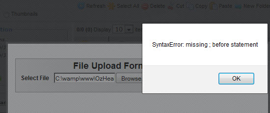

PurpleEdge Posted August 6, 2011 Share Posted August 6, 2011 I and getting a syntax error when trying to upload files from within the TinyMCE HTML editor. The error is... "SyntaxError: missing ; before statement" Does anyone know of a solution to this? I have tried with the latest versions of FF and IE, I am using PS 1.4.3 Link to comment Share on other sites More sharing options...
PurpleEdge Posted August 8, 2011 Author Share Posted August 8, 2011 This appears to be a mod_security issue with TinyMCE and its ajax file manager. My hosts were able to comment out some of the config settings and this seems to have resolved the problem, although I am uncomfortable that mod_security needed to be changed! Link to comment Share on other sites More sharing options...
codegrunt Posted October 6, 2011 Share Posted October 6, 2011 Just encountered this myself with a client. Unfortunately the ajax file manager relies on "../" in file paths passed via GET requests and this triggers mod_security's path traversal checks. Still looking to see if the there is a config option than can be used to get around this limitation (disabling mod_security is NOT a viable solution). [EDIT] After digging a bit I see this is caused by a the ajax file manager wanting a relative path in [admin dir]/ajaxfilemanager/inc/config.base.php line 51: //check if folder exist if (!is_dir('../../some/dir')) mkdir('../../some/dir'); define('CONFIG_SYS_DEFAULT_PATH', '../../some/dir'); //accept relative path only define('CONFIG_SYS_ROOT_PATH', '../../some/dir'); //accept relative path only Unfortunately the way these values are used looks like it will be a significant hack to correct this behaviour. Cheers Link to comment Share on other sites More sharing options...

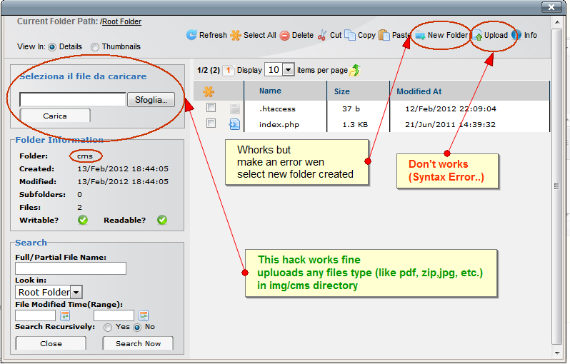

eugenata Posted February 13, 2012 Share Posted February 13, 2012 It is not a solution but allows to upload my files. (see attachment) I've found the script online and have integrated in ajaxfilemanager.php, also with its stylesheet. Download attachment for PS. 1.4.6.2: 1) only the script for uploding files (insert anywere you want in your ajafilemanager.php original or in anywere you want appears) 2) ajaxfilemanager complete hack (like you see in image - no need to do anything, just edit italian language) sorry for my english ajaxfilemanager.php upload-files.php Link to comment Share on other sites More sharing options...
