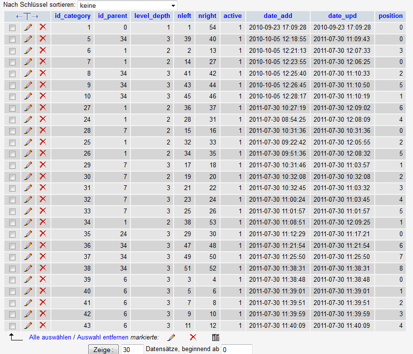

chris2407 Posted July 30, 2011 Author Share Posted July 30, 2011 ok i did make a screenshot of the positions column. Does this look fine? What can i do to fix this problem? I did install a new prestashop for testing to another database and there the sorting is working fine without any problems... so something must be messed up either in my backend or in the frontend (theme). I really appreciate your help. thanks Link to comment Share on other sites More sharing options...

shokinro Posted July 31, 2011 Share Posted July 31, 2011 I checked the screen shot you provided. But I can not tell if they are correct or not. Because I have no idea what it is displayed on your screen. Can you tell me 1. if the products displayed on the screen at back office in the same sorting of position setting in db? 2. if the products displayed on the screen at front store in the same sorting of position setting in db? Link to comment Share on other sites More sharing options...
chris2407 Posted August 1, 2011 Author Share Posted August 1, 2011 Im confused now... you said before i should check the table: ps_category and column: position right? So i did make the screenshot of it. This screenshot is not about products its the categories or am i wrong? Please tell me what i can check or which screenshot i can provide so you can check it... Link to comment Share on other sites More sharing options...
