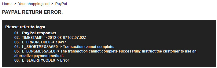

Sauls Posted August 16, 2011 Share Posted August 16, 2011 I also have the same problem some of the payments go through others give the same error code PayPal response: TIMESTAMP -> 2011-08-16T11:05:42Z L_ERRORCODE0 -> 10417 L_SHORTMESSAGE0 -> Transaction cannot complete. L_LONGMESSAGE0 -> The transaction cannot complete successfully. Instruct the customer to use an alternative payment method. L_SEVERITYCODE0 -> Error I would be very grateful for a solution. You might think using an older version will fix the problem? Im using version 1.4.4.0 Link to comment Share on other sites More sharing options...

Fabien Serny Posted August 18, 2011 Share Posted August 18, 2011 Hi, I send an e-mail to PayPal and they answer me this : The Error 10417 is generally generated when a user use more than one credit cart in his PayPal account. If one of the card is not valid, PayPal return 10417 error. But if you reinit the paiement, it will search an another paiement method (or another card), and the paiement will pass. This error is coming from PayPal, the only way to solve this is to reinit the paiement. You can't do anything for you, you should contact PayPal directly if you want more informations on this issue. Best regards, Link to comment Share on other sites More sharing options...
Sauls Posted August 18, 2011 Share Posted August 18, 2011 Hi, I send an e-mail to PayPal and they answer me this : The Error 10417 is generally generated when a user use more than one credit cart in his PayPal account. If one of the card is not valid, PayPal return 10417 error. But if you reinit the paiement, it will search an another paiement method (or another card), and the paiement will pass. This error is coming from PayPal, the only way to solve this is to reinit the paiement. You can't do anything for you, you should contact PayPal directly if you want more informations on this issue. Best regards, Thanks that makes it clear. I will put this answer on my site for my costumers. Link to comment Share on other sites More sharing options...
steve_c Posted August 19, 2011 Author Share Posted August 19, 2011 Hi I just received the error again. So if I'm getting this correct the problem is this: The buyer has more than one credit / debit card on his account. One of the cards is invalid or expired and therefore an error is returned. Is that correct? If so - is there any way to catch this error on the shop and inform the customer? I am definitely losing orders through this problem. Thanks, Stephen. Link to comment Share on other sites More sharing options...
steve_c Posted August 19, 2011 Author Share Posted August 19, 2011 And again That's three times today alone. I've also had some successful PayPal payments so it must be this error that PayPal have outlined. Link to comment Share on other sites More sharing options...
Fabien Serny Posted August 19, 2011 Share Posted August 19, 2011 I will see if I can add something in the module that I can catch the error. But you should really ask PayPal, it's not normal that you have this error three times a day. Maybe there is something wrong with your paypal account. Please keep me informed of what they say. If you can't join them, please tell me, I will join them for you. Best regards, Link to comment Share on other sites More sharing options...

Noni Posted September 26, 2011 Share Posted September 26, 2011 I received the 10417 error so after reading this thread I removed the PayPal API username, password and signature. A customer has just placed an order and paid successfully with Paypal, but no Order has been created in the backoffice. How can it be that a cart was created, details of this along with payment has been received on my paypal account, but no order created? Is this because I removed the API details?? I'm running Prestashop v1.4.4.0 and PayPal v2.6 Link to comment Share on other sites More sharing options...

Fabien Serny Posted November 12, 2011 Share Posted November 12, 2011 Hi, Unfortunately, it's a PayPal error, I can't do anything about it : http://www.prestashop.com/forums/topic/133762-to-read-error-10417-transaction-cannot-complete/ You should ask PayPal for help. Best regards, Link to comment Share on other sites More sharing options...

Austra02 Posted August 7, 2012 Share Posted August 7, 2012 This error occurs whenever PayPal cannot process a payment - even in the case where insufficient funds are in their credit card. My question is: surely this error can be captured by the PayPal module (PayPal does return the error code to PrestaShop - and I'm assuming the module), and then display it 'nicely' on the cart page instead of the horrible error that is currently returned (see attached)?? This is done in other eCommerce cart's PayPal integrations automatically - with pre-configured error messages to let the user know there is an error with the card they are trying to use. Alternatively, is there a way that I can code something to capture this error and display a nice, clean error report instructing the user that there was a problem with their card and to try another card? Thanks, Scott 1 Link to comment Share on other sites More sharing options...
