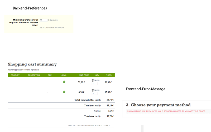

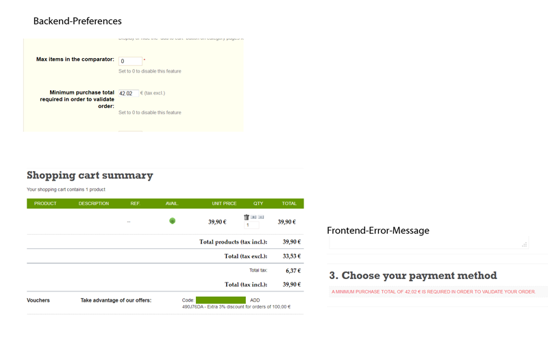

kdk Posted October 12, 2011 Share Posted October 12, 2011 Hi Mike, thanks for your help. My "target" is a minimum ourchase of 50€ incl. Tax. In the backend i added a minimum purchase of 42, 02€ (19%Tax). But the minmum Order displayed for customers is now 40,02 € - not 50 € When i add 50 € in the backend and order for less then 59,50€ I have the same situation: . I hope my problem is clear now. kdk Link to comment Share on other sites More sharing options...
kdk Posted October 12, 2011 Share Posted October 12, 2011 P.S.: The problem is not that prestashop calculates something wrong. The problem is that prestashops shows a error-message without the tax. Link to comment Share on other sites More sharing options...

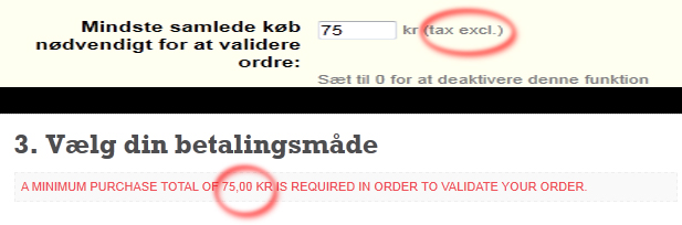

disrupt Posted April 26, 2012 Share Posted April 26, 2012 I found a very simple solution to the problem. The error message displaying the confusing tax excl. amount needs to be replaced with a custom text, not displaying the value from preferences at all. 1. under preferences set the minimum purchase to 75 KR (= the value WITHOUT the tax) 2. open controllers/OrderController.php (that's where the message about the minimum purchase is created) 3. search for "check minimal amount" and change the lines: $this->errors[] = Tools::displayError('A minimum purchase total of').' '.Tools::displayPrice($minimalPurchase, $currency). ' '.Tools::displayError('is required in order to validate your order.'); to $this->errors[] = Tools::displayError('You have not reached the order minimum of 100 KR yet!'); 2 Link to comment Share on other sites More sharing options...
