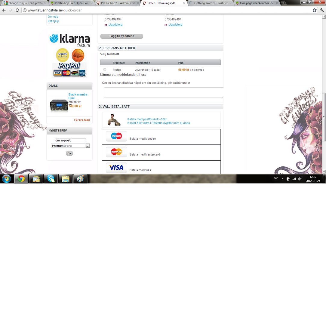

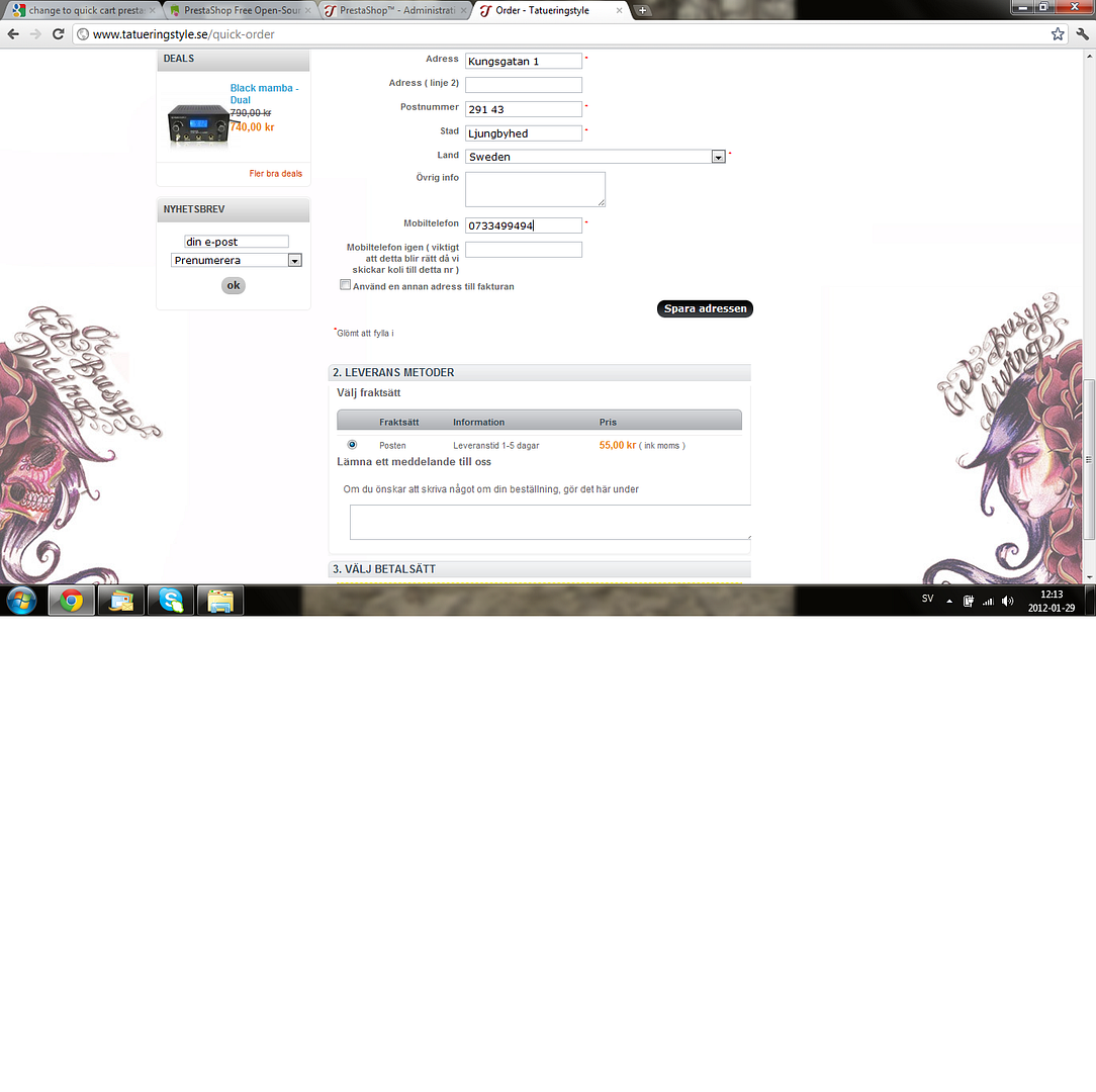

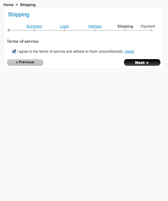

teriff Posted January 29, 2012 Share Posted January 29, 2012 I have the same problem and it makes it confusing to customers. I use version: 1.4.6.2 , and find it hard to believe that everyone that runs prestashop sites that are at least 6 months old have this problem and that there is no solution to the problem It happens only when a new customer that have added items to the cart saves there address and then the check box for the shipping method is unboxed and there is no way to make it checked in again. Before saving the addres: http://i283.photobucket.com/albums/kk319/teriff/checkout.png After saving the addres: http://i283.photobucket.com/albums/kk319/teriff/checkout1.png So please inform , how this can be fixed Link to comment Share on other sites More sharing options...

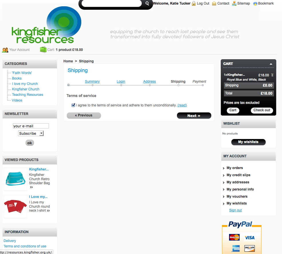

popcorn1985 Posted January 31, 2012 Share Posted January 31, 2012 Anyone able to help or even point me as to where I should be looking? I would really appreciate it as I am loosing buisness - have had so many carts abandoned the past few days as people can't properly order! I have attached a couple of screenshots to show what is happening! Thank you for looking Link to comment Share on other sites More sharing options...
tomerg3 Posted January 31, 2012 Share Posted January 31, 2012 Can you post a link to the site? with the exact step to re-create the issue, and the version of PS you use. Link to comment Share on other sites More sharing options...
popcorn1985 Posted January 31, 2012 Share Posted January 31, 2012 Hi, My site is www.resources.kingfisher.org.uk and it's whenever you try to order something - the website doesn't show any shipping options - they are configured but they don't show I am using version 1.4.6.2 Thank you! Link to comment Share on other sites More sharing options...

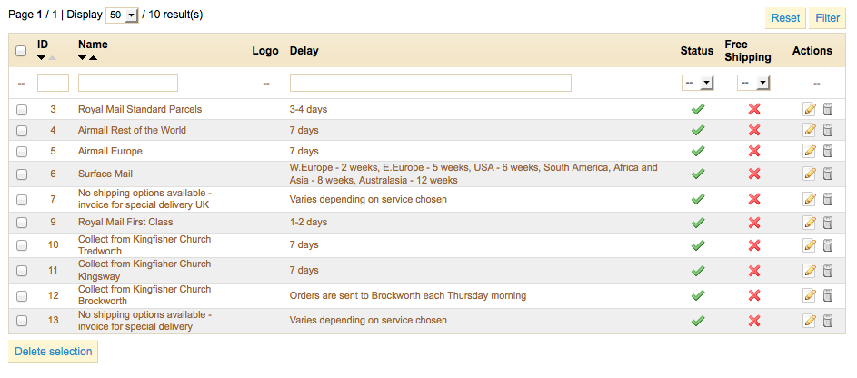

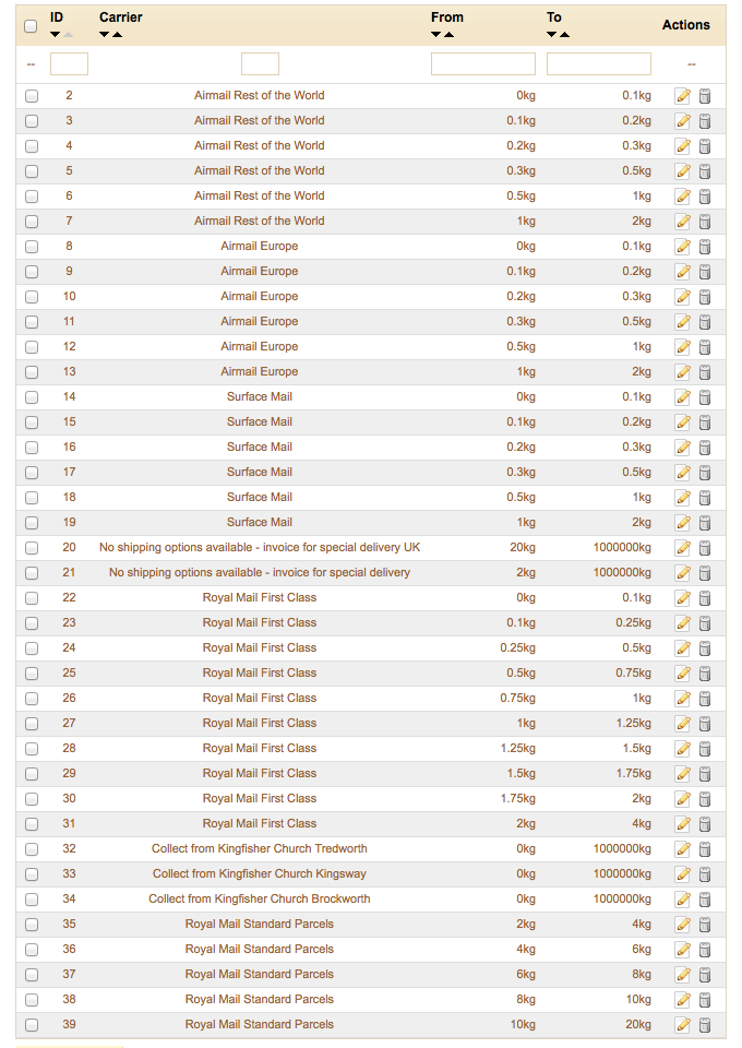

tomerg3 Posted January 31, 2012 Share Posted January 31, 2012 Are you should they are configured correctly? Did you follow all the steps? Can you post images of all the pages you defined shipping in? Link to comment Share on other sites More sharing options...

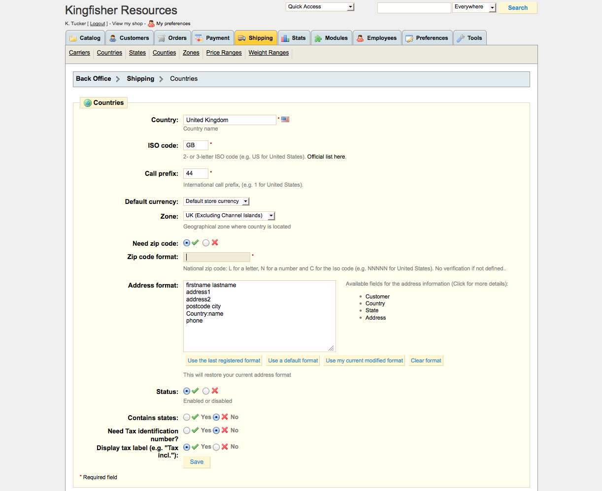

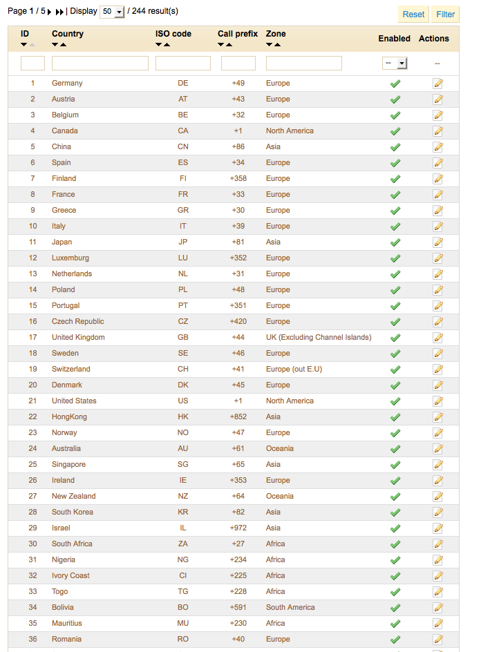

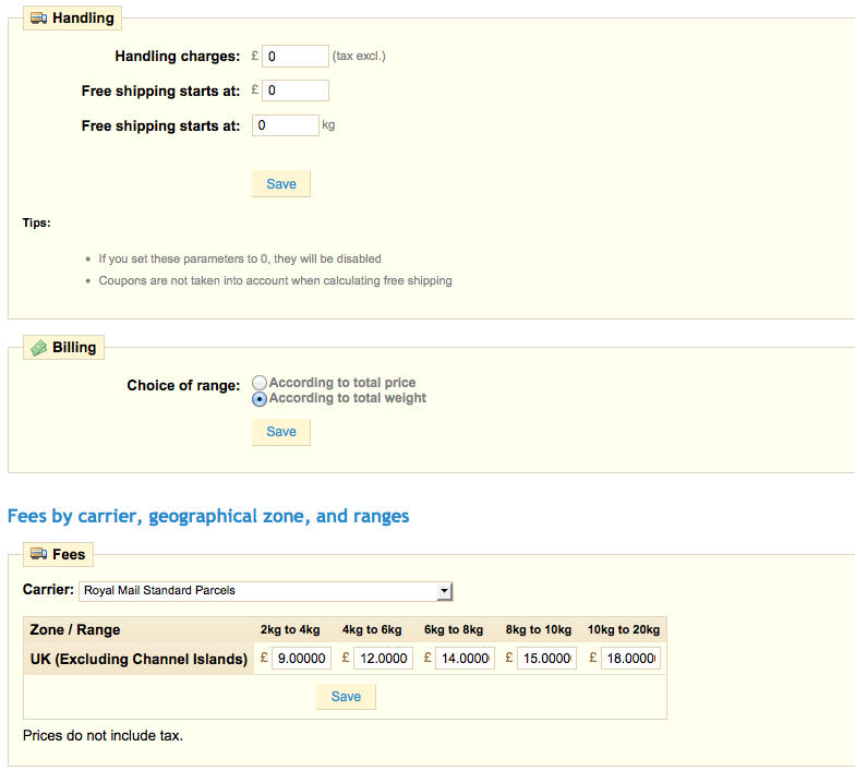

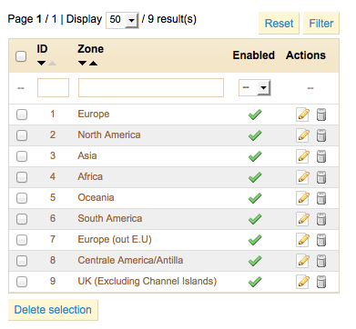

popcorn1985 Posted February 1, 2012 Share Posted February 1, 2012 Hi, Thanks so much - you have helped me out a few times and appreciate it! Here are the screenshots of the shipping config - the wierd thing is I am sure this was all working a while ago - and I haven't changed anything that I can remember - but anyways here is the shots! Link to comment Share on other sites More sharing options...
tomerg3 Posted February 1, 2012 Share Posted February 1, 2012 It's very hard to know what is going on when you do not include the entire page in the screenshot. Did you save the rates for all the ranges? I see you created a new zone, did you move the country + all the states to that new zone? Link to comment Share on other sites More sharing options...
popcorn1985 Posted February 1, 2012 Share Posted February 1, 2012 Sorry, will post full pics in future! I saved the rates for all the ranges and I put a country into the new zone and have disabled the use of states as it's not necessary in the UK. It has worked before and the weird thing is when people that have registered previously place an order, it automatically assigns them a carrier based on their selection before - it seems the shipping methods work, but for some reason are not showing up on the front office. I have error reporting turned on and there is no error message - it's as if the step needed for shipping just doesn't exist...it's very odd! Link to comment Share on other sites More sharing options...
tomerg3 Posted February 1, 2012 Share Posted February 1, 2012 I am not sure what could be wrong there. it would require some more serious debugging to find out where it is breaking. You could try to make a copy for the shop (as a development environment) and remove all carriers there and try again. Link to comment Share on other sites More sharing options...
