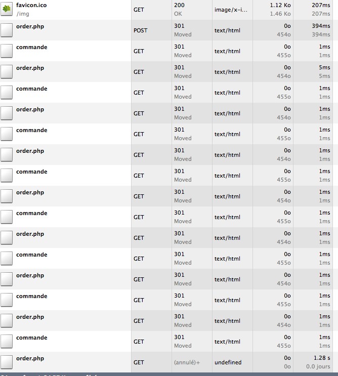

Matthieu Brunet Posted September 9, 2011 Share Posted September 9, 2011 I have the same problem, but only when playing with address on the commande?step=1? page. When I click on the menu to select another address, the error appears. If I disable url rewritting, it works normally. I regenerated the htaccess without success. I tried to generate the htaccess without optimisation and without multiview, but no luck neither. When I look to my console, I see that when I select another address, I have the page order.php and "commande" (which is the SEF url oh the same page in french) called 10 times each in a row, with always a 301 moved answer. The last one is cancelled. So it looks like a redirection loop. URL de la requête:https://boutique.arcadie-sa.fr/commande Méthode de la requête:GET Code d’état:301 Moved En-têtes de requêteafficher la source Accept:application/json, text/javascript, */*; q=0.01 Accept-Encoding:gzip, deflate Accept-Language:fr-fr Origin:https://boutique.arcadie-sa.fr --->Referer:https://boutique.arcadie-sa.fr/commande?step=1 User-Agent:Mozilla/5.0 (Macintosh; Intel Mac OS X 10_6_8) AppleWebKit/534.50 (KHTML, like Gecko) Version/5.1 Safari/534.50 X-Requested-With:XMLHttpRequest En-têtes de réponseafficher la source Cache-Control:no-cache, must-revalidate Connection:close Content-Encoding:gzip Content-Length:20 Content-Type:text/html; charset=utf-8 Date:Fri, 09 Sep 2011 13:28:20 GMT Expires:Mon, 26 Jul 1997 05:00:00 GMT --->Location:https://boutique.arcadie-sa.fr/order.php Server:Apache/2.2.9 (Debian) PHP/5.2.17-0.dotdeb.0 with Suhosin-Patch mod_ssl/2.2.9 OpenSSL/0.9.8g Vary:Accept-Encoding X-Powered-By:PHP/5.2.17-0.dotdeb.0 The strange things is that the address is actually changed, so everything seems to work. Only the error is thrown. PS 1.4.4.1 # URL rewriting rules RewriteRule ^api/?(.*)$ /webservice/dispatcher.php?url=$1 [QSA,L] RewriteRule ^([0-9])(\-[_a-zA-Z0-9-]*)?/[_a-zA-Z0-9-]*\.jpg$ /img/p/$1/$1$2.jpg [L] RewriteRule ^([0-9])([0-9])(\-[_a-zA-Z0-9-]*)?/[_a-zA-Z0-9-]*\.jpg$ /img/p/$1/$2/$1$2$3.jpg [L] RewriteRule ^([0-9])([0-9])([0-9])(\-[_a-zA-Z0-9-]*)?/[_a-zA-Z0-9-]*\.jpg$ /img/p/$1/$2/$3/$1$2$3$4.jpg [L] RewriteRule ^([0-9])([0-9])([0-9])([0-9])(\-[_a-zA-Z0-9-]*)?/[_a-zA-Z0-9-]*\.jpg$ /img/p/$1/$2/$3/$4/$1$2$3$4$5.jpg [L] RewriteRule ^([0-9])([0-9])([0-9])([0-9])([0-9])(\-[_a-zA-Z0-9-]*)?/[_a-zA-Z0-9-]*\.jpg$ /img/p/$1/$2/$3/$4/$5/$1$2$3$4$5$6.jpg [L] RewriteRule ^([0-9])([0-9])([0-9])([0-9])([0-9])([0-9])(\-[_a-zA-Z0-9-]*)?/[_a-zA-Z0-9-]*\.jpg$ /img/p/$1/$2/$3/$4/$5/$6/$1$2$3$4$5$6$7.jpg [L] RewriteRule ^([0-9])([0-9])([0-9])([0-9])([0-9])([0-9])([0-9])(\-[_a-zA-Z0-9-]*)?/[_a-zA-Z0-9-]*\.jpg$ /img/p/$1/$2/$3/$4/$5/$6/$7/$1$2$3$4$5$6$7$8.jpg [L] RewriteRule ^([0-9])([0-9])([0-9])([0-9])([0-9])([0-9])([0-9])([0-9])(\-[_a-zA-Z0-9-]*)?/[_a-zA-Z0-9-]*\.jpg$ /img/p/$1/$2/$3/$4/$5/$6/$7/$8/$1$2$3$4$5$6$7$8$9.jpg [L] RewriteRule ^c/([0-9]+)(\-[_a-zA-Z0-9-]*)/[_a-zA-Z0-9-]*\.jpg$ /img/c/$1$2.jpg [L] RewriteRule ^c/([a-zA-Z-]+)/[a-zA-Z0-9-]+\.jpg$ /img/c/$1.jpg [L] RewriteRule ^([0-9]+)\-[a-zA-Z0-9-]*\.html /product.php?id_product=$1 [QSA,L] RewriteRule ^([0-9]+)\-[a-zA-Z0-9-]* /category.php?id_category=$1 [QSA,L] RewriteRule ^[a-zA-Z0-9-]*/([0-9]+)\-[a-zA-Z0-9-]*\.html /product.php?id_product=$1 [QSA,L] RewriteRule ^([0-9]+)__([a-zA-Z0-9-]*) /supplier.php?id_supplier=$1 [QSA,L] RewriteRule ^([0-9]+)_([a-zA-Z0-9-]*) /manufacturer.php?id_manufacturer=$1 [QSA,L] RewriteRule ^content/([0-9]+)\-([a-zA-Z0-9-]*) /cms.php?id_cms=$1 [QSA,L] RewriteRule ^content/category/([0-9]+)\-([a-zA-Z0-9-]*) /cms.php?id_cms_category=$1 [QSA,L] RewriteRule ^([0-9]+)(\-[_a-zA-Z0-9-]*)/[_a-zA-Z0-9-]*\.jpg$ /img/c/$1$2.jpg [L] RewriteRule ^page-non-trouvee$ /404.php [QSA,L] RewriteRule ^adresse$ /address.php [QSA,L] RewriteRule ^adresses$ /addresses.php [QSA,L] RewriteRule ^authentification$ /authentication.php [QSA,L] RewriteRule ^meilleures-ventes$ /best-sales.php [QSA,L] RewriteRule ^panier$ /cart.php [QSA,L] RewriteRule ^contactez-nous$ /contact-form.php [QSA,L] RewriteRule ^bons-de-reduction$ /discount.php [QSA,L] RewriteRule ^suivi-commande-invite$ /guest-tracking.php [QSA,L] RewriteRule ^historique-des-commandes$ /history.php [QSA,L] RewriteRule ^identite$ /identity.php [QSA,L] RewriteRule ^fabricants$ /manufacturer.php [QSA,L] RewriteRule ^mon-compte$ /my-account.php [QSA,L] RewriteRule ^nouveaux-produits$ /new-products.php [QSA,L] RewriteRule ^commande$ /order.php [QSA,L] RewriteRule ^details-de-la-commande$ /order-follow.php [QSA,L] RewriteRule ^commande-rapide$ /order-opc.php [QSA,L] RewriteRule ^avoirs$ /order-slip.php [QSA,L] RewriteRule ^mot-de-passe-oublie$ /password.php [QSA,L] RewriteRule ^promotions$ /prices-drop.php [QSA,L] RewriteRule ^recherche$ /search.php [QSA,L] RewriteRule ^plan-du-site$ /sitemap.php [QSA,L] RewriteRule ^magasins$ /stores.php [QSA,L] RewriteRule ^fournisseurs$ /supplier.php [QSA,L] </IfModule> Link to comment Share on other sites More sharing options...

Matthieu Brunet Posted September 9, 2011 Share Posted September 9, 2011 Thanks a lot, but I use PS 1.4.4.1 and the option is already present. So I checked it, and still have the problem. But I have the problem only with the address, not with the guest checkout. So it may be a bug fork ? You can test it there hxxp://boutique.arcadie-sa.fr create an account, create two address, and try to change it in the order process. Tested on Mac os X safari-chrome-firefox. Thanks. Link to comment Share on other sites More sharing options...

Matthieu Brunet Posted October 12, 2011 Share Posted October 12, 2011 Yes ! I found another thread with the good solution... I'm not sure which one i used, but I think it's the canonical url tips. Link to comment Share on other sites More sharing options...
