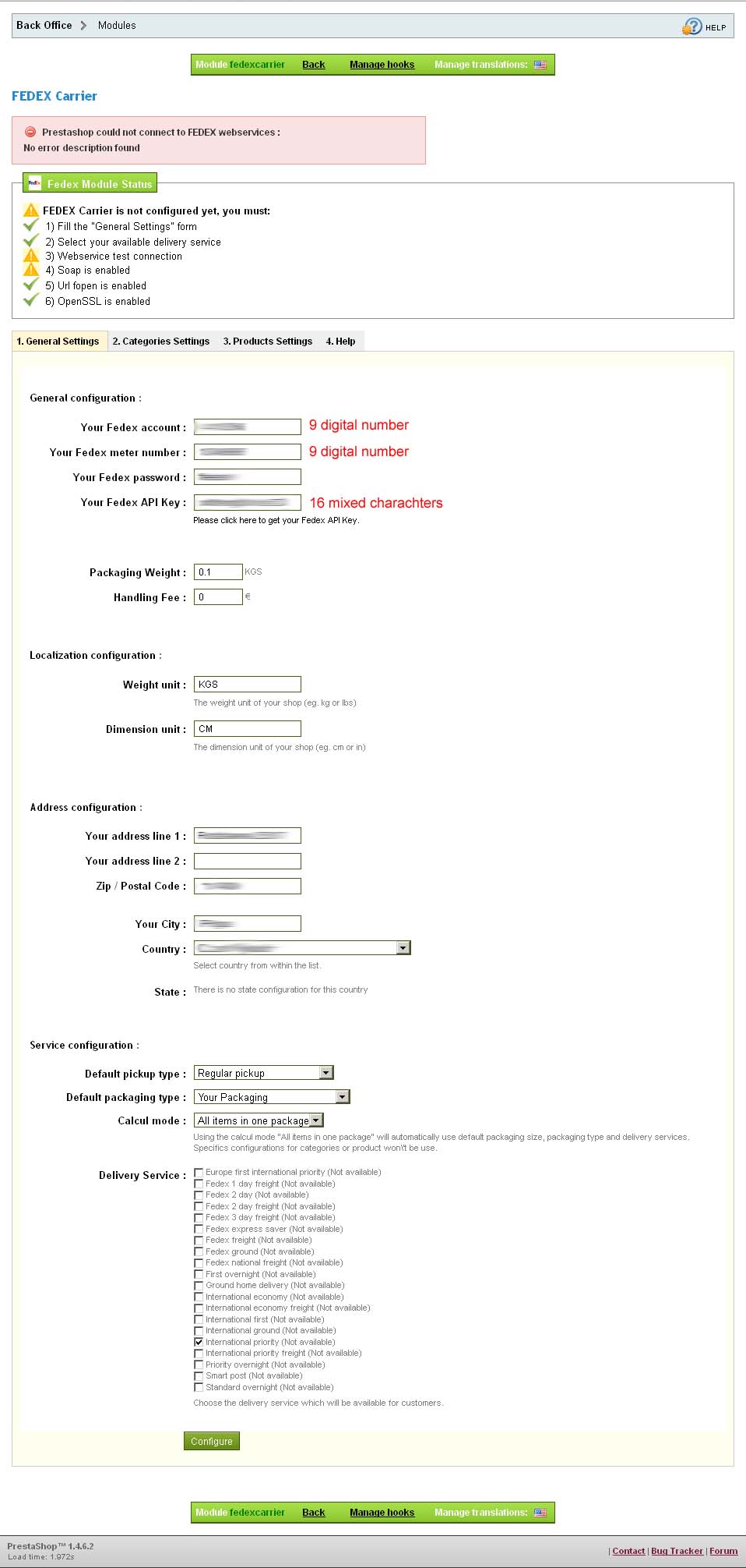

gdinari Posted July 6, 2011 Share Posted July 6, 2011 Im am trying to use the FedEx module, but everything checks out except step#3 which says "Fedex Webservice seems to be down." Im not sure exactly how the webservice works, but I generated a key, gave it a description, gave permissions.I get this error:Prestashop could not connect to FEDEX webservices :Fedex Webservice seems to be down, please wait a few minutes and try again.I would appreciate some help with this issue. I really want to use this module...its long overdue.Thanks a lot.gdinari Link to comment Share on other sites More sharing options...

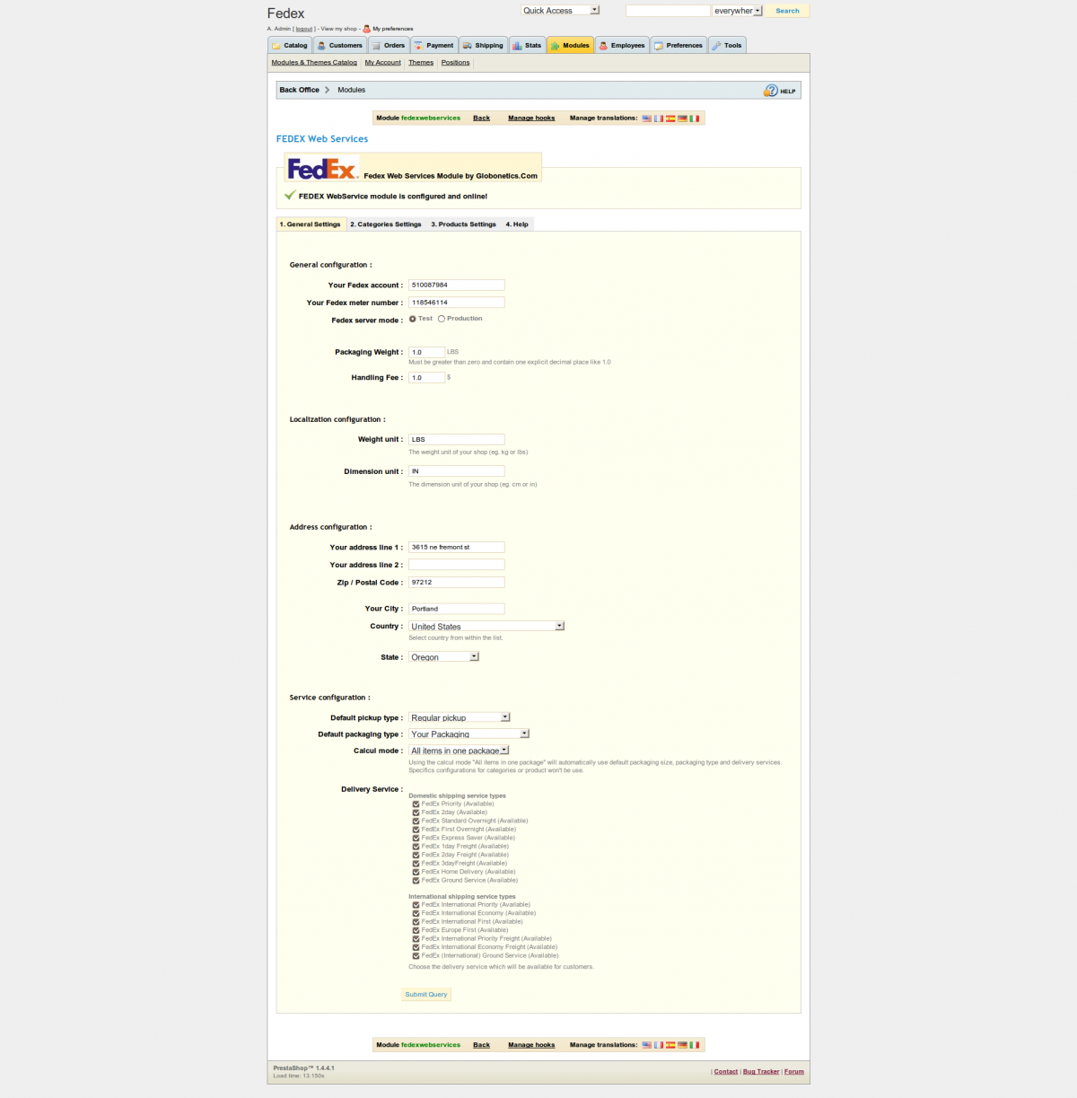

reeecheee Posted July 17, 2011 Share Posted July 17, 2011 I am having the same problem. Anyone know how to correct this? I thought maybe prestashop is pointing to the wrong area? Does anyone know where I would go in PS to change the location its pointing to? I got all info from fedex where we should be trying to connect but dont know how to see where PS is trying to connect. Link to comment Share on other sites More sharing options...

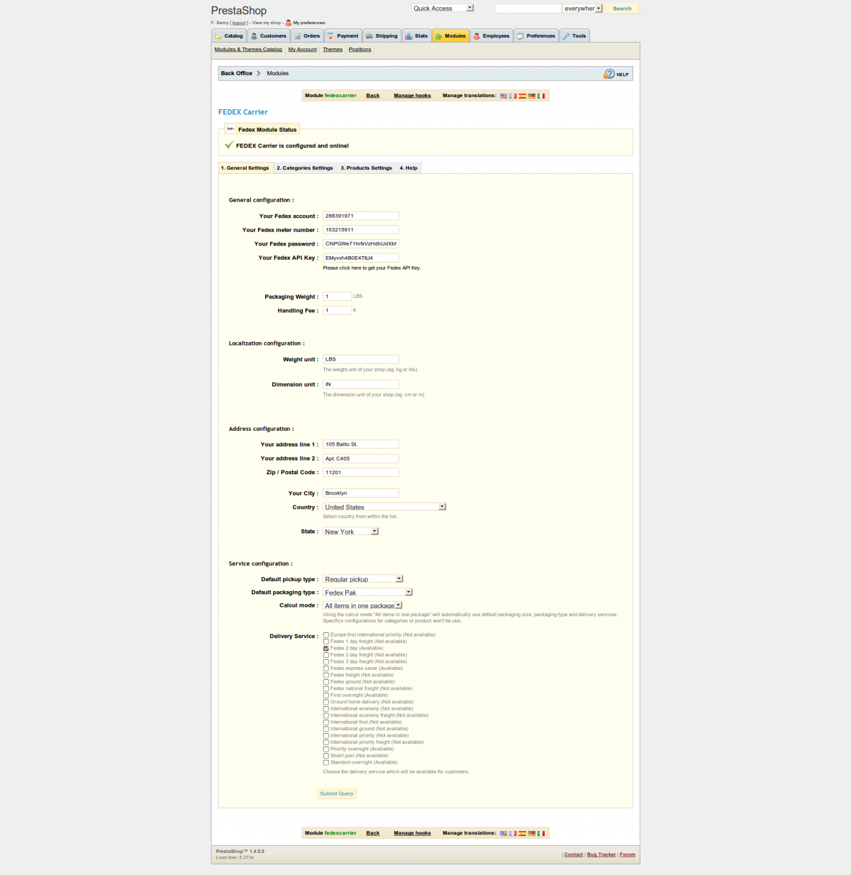

zyko Posted September 29, 2011 Share Posted September 29, 2011 Im am trying to use the FedEx module, but everything checks out except step#3 which says "Fedex Webservice seems to be down." Im not sure exactly how the webservice works, but I generated a key, gave it a description, gave permissions. I get this error: Prestashop could not connect to FEDEX webservices : Fedex Webservice seems to be down, please wait a few minutes and try again. I would appreciate some help with this issue. I really want to use this module...its long overdue. Thanks a lot. gdinari Did anybody checked this fedex webservices module http://www.prestasho...k-with-ps-1441/ Link to comment Share on other sites More sharing options...
Fabien Serny Posted September 29, 2011 Share Posted September 29, 2011 Hi Zyko, What is the difference between your module and the native module ? It looks exactly the same and the native one is free. Could you tell me what the difference ? I attached a screenshot of the free module and your module. Best regards, Link to comment Share on other sites More sharing options...

Fabien Serny Posted November 19, 2011 Share Posted November 19, 2011 Hi, Htaccess should not change anything (except if your developers disabled open ssl for PHP5, but I don't think it's the case). In the fedex module, do you see that OpenSSL is enabled or not ? I wanted to check by myself but the employee account you gave me seems to be disabled. Link to comment Share on other sites More sharing options...
reeecheee Posted November 21, 2011 Share Posted November 21, 2011 the log in hasnt changed. You just have to go to admin347/index.php to log in It doesnt look like openssl is enabled. How do I do this? Link to comment Share on other sites More sharing options...
reeecheee Posted November 30, 2011 Share Posted November 30, 2011 How do I enable openssl? Link to comment Share on other sites More sharing options...
Fabien Serny Posted December 1, 2011 Share Posted December 1, 2011 As I already said, ask your hosting provider, he is only the one who can enable it. Link to comment Share on other sites More sharing options...
reeecheee Posted December 1, 2011 Share Posted December 1, 2011 lol ok I made some progress finally. My host has it enabled but when I called him today he noticed 2 different php versions on the server and one was not enabled. The fedex module now says its working but.... all options are showing as available on the site and all options are saying they are free. Any idea's? Thanks for helping me BTW. I know this has been extremely a pain in the a$$!!!! Link to comment Share on other sites More sharing options...

Fabien Serny Posted December 13, 2011 Share Posted December 13, 2011 On your screenshot, it is written that Soap is not enabled. This is the problem, please contact your hosting provider to enable it. Best regards, Link to comment Share on other sites More sharing options...
prhps Posted December 13, 2011 Share Posted December 13, 2011 (edited) what is SOAP? anyway, i have contacted my hosting provider, will see what they can do. I will inform about this. Thanks, Fabien. Edited December 13, 2011 by prhps (see edit history) Link to comment Share on other sites More sharing options...
Fabien Serny Posted December 13, 2011 Share Posted December 13, 2011 Soap is a PHP extension that must be enabled to use this module. Link to comment Share on other sites More sharing options...
