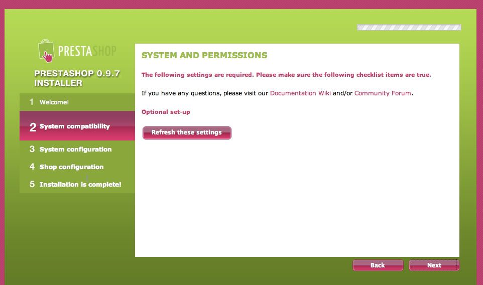

EKS Posted March 10, 2008 Share Posted March 10, 2008 Hey guys i've read all of the post concerning the install getting stuck on step two. I tried uploading the alternate Config.php file in the xml directory. Still having problems. I changed all of the file permissions to the correct configurations. Any help will be greatly appreciated. Attached is the screen i'm still getting. Link to comment Share on other sites More sharing options...

Lucas Cherifi Posted April 2, 2008 Share Posted April 2, 2008 Hi all ! The better way to fix this problem is via some diagnostics : -Run a PrestaShop install with Firefox + Firebug https://addons.mozilla.org/fr/firefox/addon/1843 module (installed and activated) -Try to reproduce the bug -When the bug is found, open the Firebug tab, look at the last request in the 'console' tab, and expand it. -Then open the 'response' tab of this request -Copy/paste this request in this thread Thanks, Link to comment Share on other sites More sharing options...

www.northshorepc.net Posted June 24, 2008 Share Posted June 24, 2008 Hey guys, I'm new here, and love what I see out of PrestaShop. I have encountered the same problem as previously mentioned and figured I would start the movement forward for the GoDaddy users. The following is the error information from FireBug using the install script on GoDaddy:NOTE: GoDaddy Shared Hosting: Linux PHP 5 activated through hosting control panel.PrestaShop 1RC3ERROR IN FIREBUG-----------------------ret.getElementsByTagName is not a functionhttp://northshorewisp.com/presta/install/controller.jsLine 244HTACCESS--------------# switch GoDaddy's php extension handling for php5 AddHandler x-httpd-php5 .php AddHandler x-httpd-php .php4 Options +FollowSymLinks RewriteEngine On RewriteBase /PHP.INI----------//Presta Shopextension=php_gd2.dllregister_globals = off*I will keep my eyes open for an update or suggestions on this issue. In the mean time I will have a closer look at it later on to see if I can figure anything out about it. (-Not A Coder-) Link to comment Share on other sites More sharing options...

www.northshorepc.net Posted June 26, 2008 Share Posted June 26, 2008 ret.getElementsByTagName is not a functionsuccess()()success()(?)()()[break on this error] testLists = ret.getElementsByTagName('testList');That's the remainder of the error I get Right now it appears everything in the Install DIR is set to 644. Link to comment Share on other sites More sharing options...

Applejax Posted July 1, 2008 Share Posted July 1, 2008 I had this same error whn I was doing an installation. I found that godaddy runs thier stuff on windows servers. You need to make sure that u select php5 to run as an ISAPI extention no as a CGI app Link to comment Share on other sites More sharing options...

DrÿSs' Posted July 11, 2008 Share Posted July 11, 2008 I think there are one big bug on the host godaddy.comI tried to fix installer, what I did : variables posted in ajax POST are NOT available.So, I passed all installer by ajax GET, and it's working.BUT, after installation succesfull, impossible to log-in back-office : again, all variables passed by POST don't work !!!!Nothing in $_POST, $GLOBALS or $REQUEST (this one has only GET variables) or $HTTP_VARS.So I think you need to call your host service and tell them that there is a big problem.First time I see this kind of thing ô.O) Link to comment Share on other sites More sharing options...
