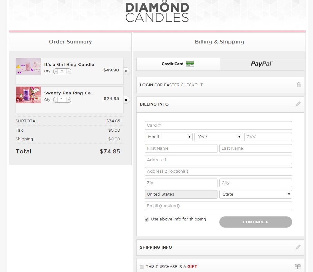

shokinro Posted June 3, 2011 Share Posted June 3, 2011 Sorry, I seems I really misunderstood you this time. :-) Quote Take a look at the image below. I’m on the guest checkout page, so I don’t want to make an account, but then I see the text marked with red. What should I think as a customer? I think it is really confusing, especially for those customer to do guest checkout.My suggestion is change message to "Please sign in or click Guest Checkout to fill your address to see payment".This is the easiest way to do to avoid confusing.You can change message though translation function of PrestaShopTools - Translations - choose "Error Message Translations" Link to comment Share on other sites More sharing options...
diana13 Posted June 3, 2011 Author Share Posted June 3, 2011 It seems that it's not an easy way to show directly the payment method. Eventually, I'll change the message, but it's very strange to see that message, when I have just one payment method. It seems that I have some sort of secret payment methods hiding there )I don't know if I should mark this topic as solved. I am tempted to leave it as it is now, maybe someone will find a solution to display directly the payment method. Link to comment Share on other sites More sharing options...
shokinro Posted June 3, 2011 Share Posted June 3, 2011 In PrestaShop, shipping and payment method are related to country/region, so it requires customer address to get the list of payment methods. I don't think there is any easy to change that, it will requires some customization coding.It doesn't matter leave this topic as open so maybe someone could give a better answer. Link to comment Share on other sites More sharing options...
