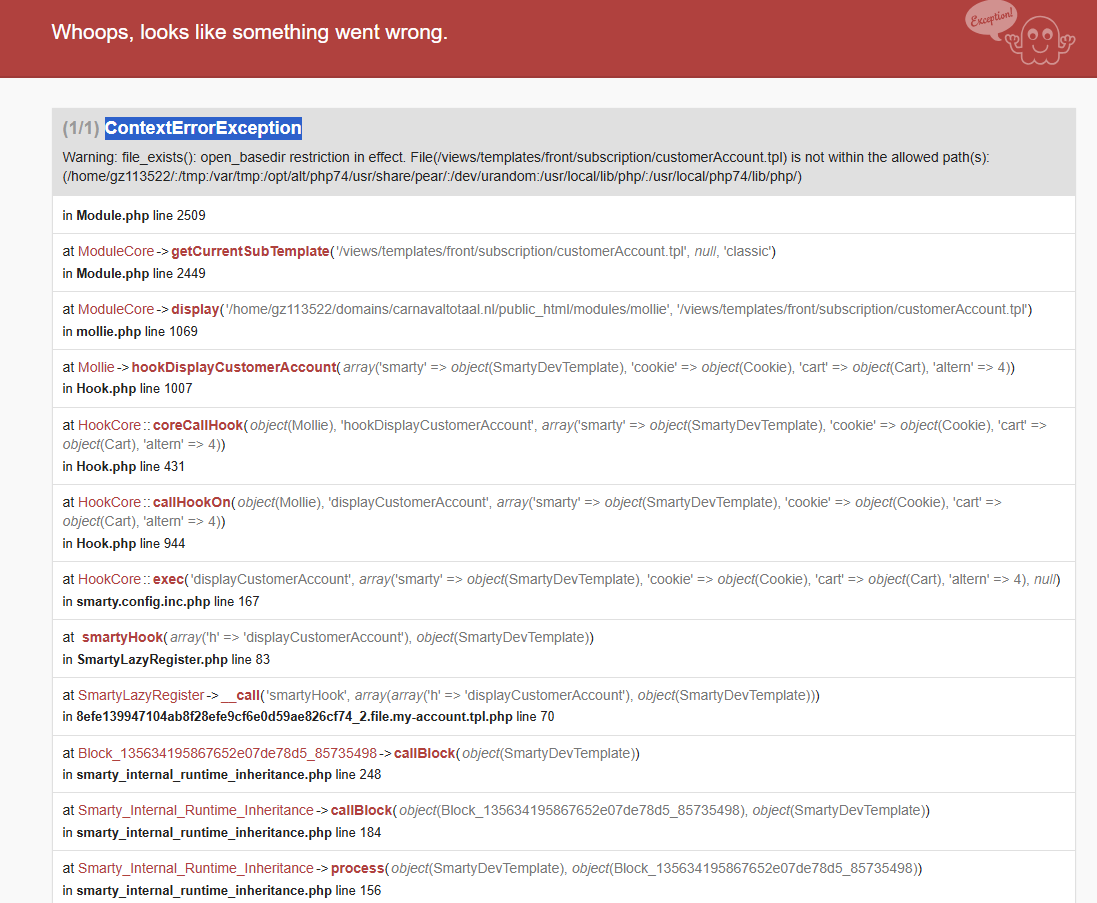

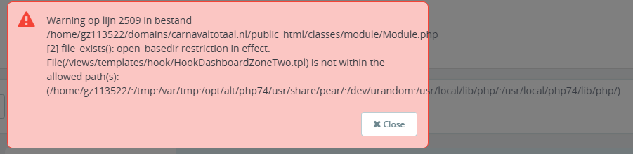

Bits & Baits Posted Friday at 08:59 AM Share Posted Friday at 08:59 AM Hello, I'm getting a Error in the backend as shown below. "Warning on line 2509 in file /home/...../..../classes/module/Module.php Also, when an order is placed and confirmed, I see a page that says there is a ContextErrorException. I think this has to do with the above issue Could somebody tell me how to solve this? Thanks in advanced. Link to comment Share on other sites More sharing options...
Prestashop Addict Posted Friday at 09:23 AM Share Posted Friday at 09:23 AM Bonjour, si vous n'êtes pas en serveur dédié ou vps, voyez avec votre hébergeur c'est un problème de droit sur des dossiers systèmes. Link to comment Share on other sites More sharing options...
ST-THEMES Posted yesterday at 10:03 AM Share Posted yesterday at 10:03 AM Hi, The problem is due to your mollie module, you can contact the developer to modify the files to fix it. Best regards. Link to comment Share on other sites More sharing options...
