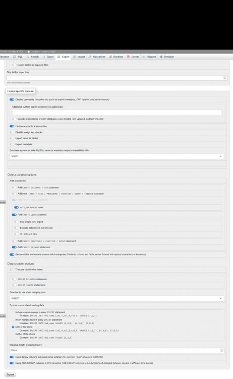

ComGrafPL Posted 11 hours ago Share Posted 11 hours ago Whats your output format in PHPmyadmin? Link to comment Share on other sites More sharing options...
tivicrdotcom Posted 11 hours ago Author Share Posted 11 hours ago I started exporting just 20 tables at a time. Initially, I split the database into two parts, but the second half alone was 9GB, which clearly isn’t right. Now, I’m doing smaller exports. It’s possible that one table is carrying most of the weight, but it’s hard to pinpoint. Link to comment Share on other sites More sharing options...
