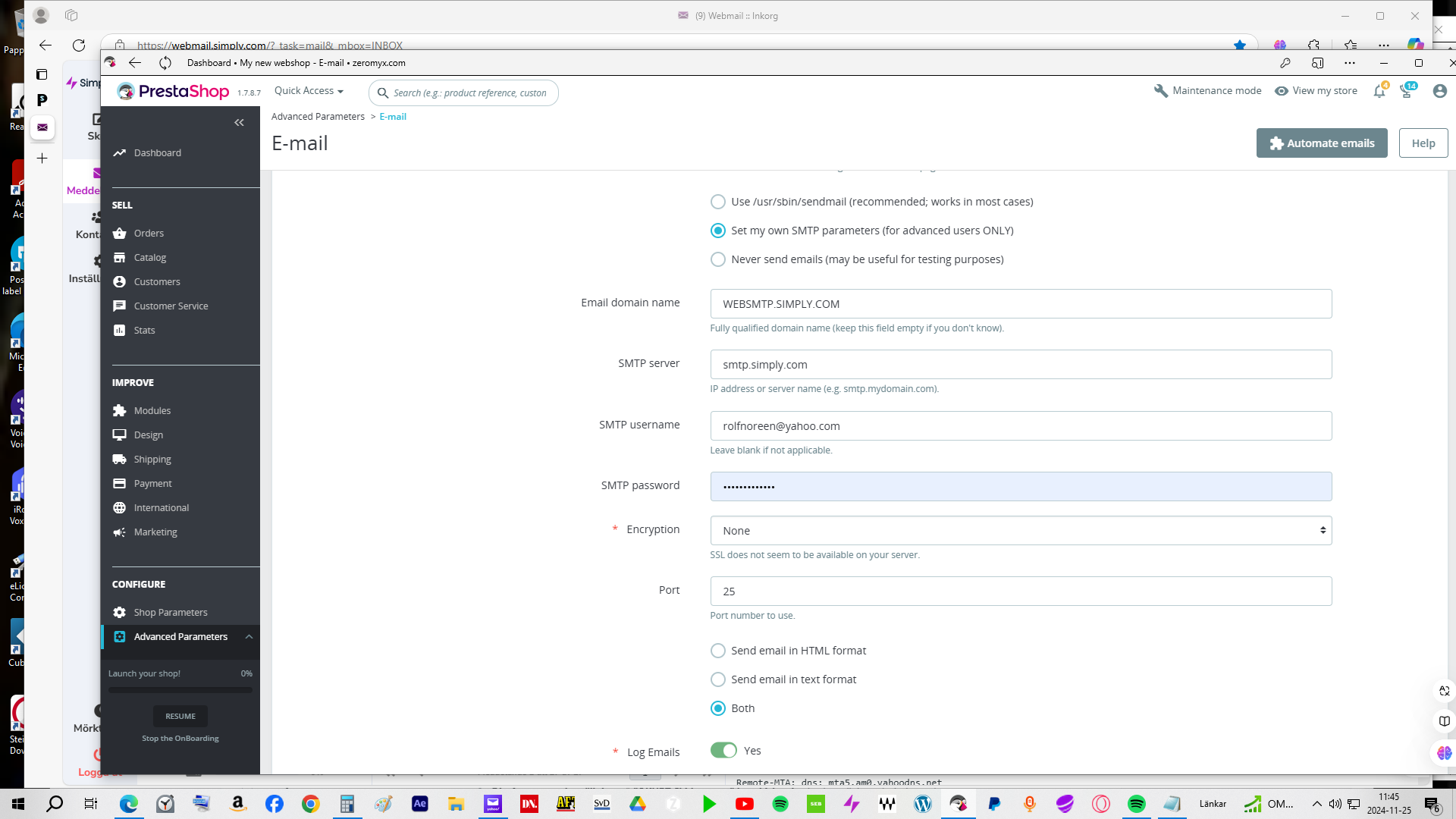

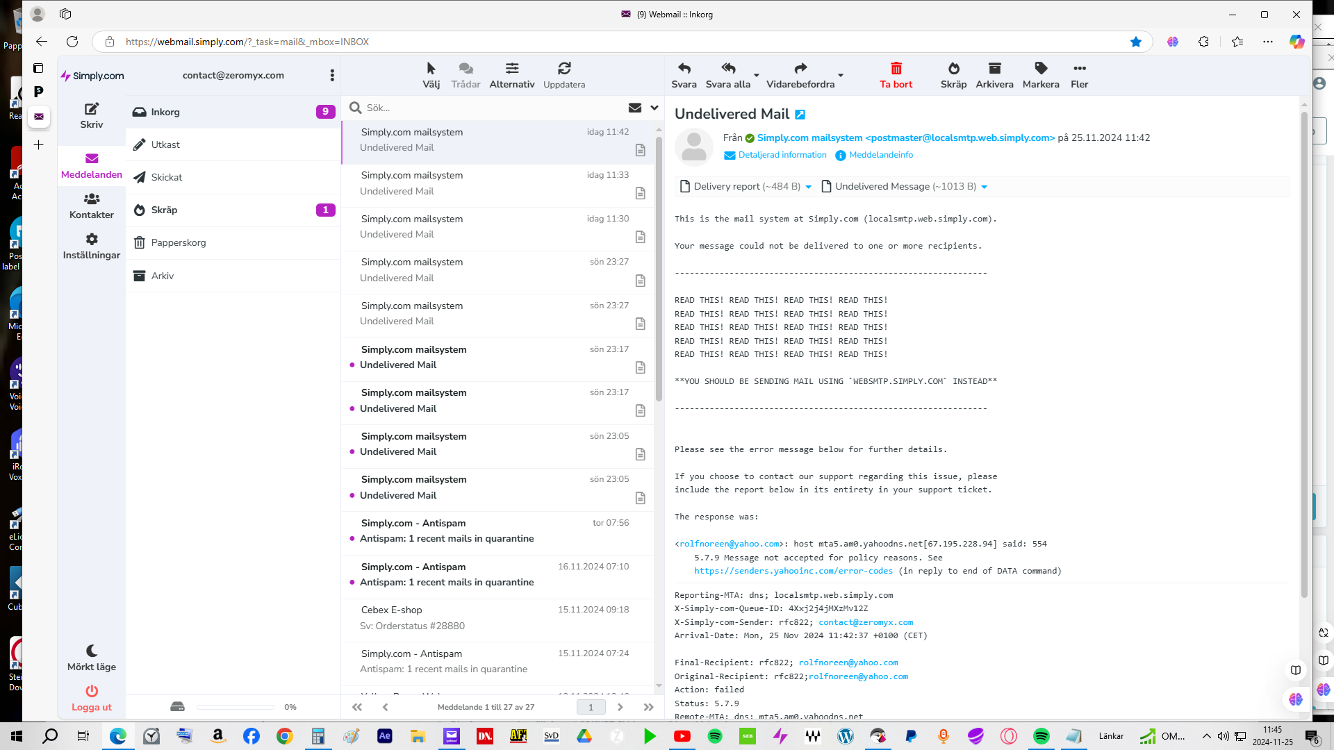

rolnor Posted 4 hours ago Author Share Posted 4 hours ago 3 hours ago, pallavigodse said: First check your spam or junk folders. If your emails are not in these folders, go to Back Office -> Advance Parameters -> Email to check if your email settings are configured correctly. Are you using SMTP? If yes, check its settings. Also, if all these don't work contact your hosting provider as there might me a server issue. Thanx, I get error message at my webhost simply.com. Its probably some parameters? I get nothing when I try the smpt but that can be because I dont have all the parameters correct. I include some images: Link to comment Share on other sites More sharing options...
