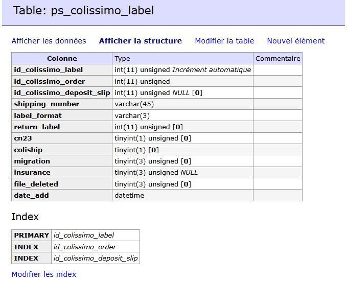

Eolia Posted November 21, 2024 Share Posted November 21, 2024 ALTER TABLE `ps_colissimo_label` ADD COLUMN `cn23_format` VARCHAR(3) NOT NULL AFTER `label_format`; ALTER TABLE `ps_colissimo_address` ADD COLUMN `phone` VARCHAR(20) NULL AFTER `code_porte2`; Dans les 2 derniers upgrades mais il va vous manquer d'autres éléments (nouveaux statuts etc ) Link to comment Share on other sites More sharing options...

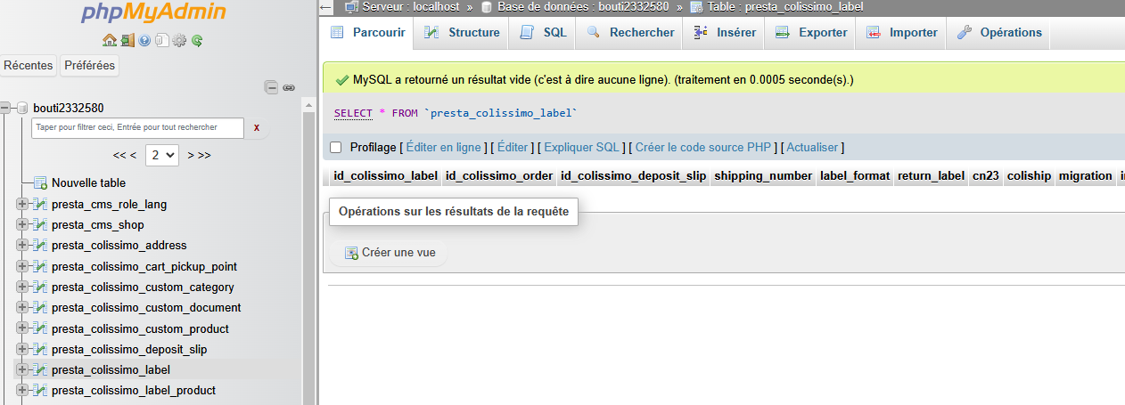

Eolia Posted November 22, 2024 Share Posted November 22, 2024 Votre table ps_colissimo_label est ok ou pas à présent ? Link to comment Share on other sites More sharing options...
Edgar Sandé Posted November 22, 2024 Author Share Posted November 22, 2024 1 hour ago, Eolia said: Votre table ps_colissimo_label est ok ou pas à présent ? Apparemment non, puisque je vois qu'elle est vide !! Auriez-vous une solution ? Merci beaucoup ppour votre aide PS : je n'ai pas beaucoup de connaissance pour modifier manuellement les tables de ma BDD Link to comment Share on other sites More sharing options...

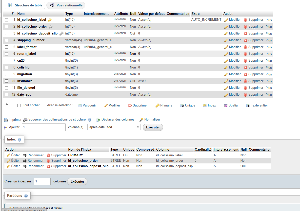

Eolia Posted November 22, 2024 Share Posted November 22, 2024 je ne parle pas de ce qu'elle contient mais de sa structure Link to comment Share on other sites More sharing options...
Edgar Sandé Posted November 22, 2024 Author Share Posted November 22, 2024 Ah désolé .... voilà un screen shot Link to comment Share on other sites More sharing options...
Eolia Posted November 22, 2024 Share Posted November 22, 2024 (edited) Ok donc exécutez ces 2 requêtes dans l'onglet "SQL" ALTER TABLE `presta_colissimo_label` ADD COLUMN `cn23_format` VARCHAR(3) NOT NULL AFTER `label_format`; ALTER TABLE `presta_colissimo_address` ADD COLUMN `phone` VARCHAR(20) NULL AFTER `code_porte2`; Edited November 22, 2024 by Eolia (see edit history) Link to comment Share on other sites More sharing options...
Edgar Sandé Posted November 23, 2024 Author Share Posted November 23, 2024 17 hours ago, Eolia said: Ok donc exécutez ces 2 requêtes dans l'onglet "SQL" ALTER TABLE `presta_colissimo_label` ADD COLUMN `cn23_format` VARCHAR(3) NOT NULL AFTER `label_format`; ALTER TABLE `presta_colissimo_address` ADD COLUMN `phone` VARCHAR(20) NULL AFTER `code_porte2`; Super, ça a marché Mille mercis pour votre aide précieuse 🙏🙏 Bon week-end Link to comment Share on other sites More sharing options...

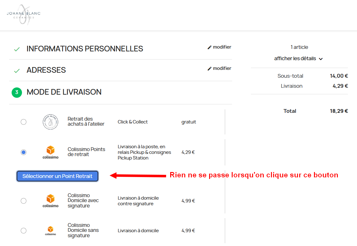

Edgar Sandé Posted November 27, 2024 Author Share Posted November 27, 2024 Re bonjour Désolé de vous solliciter à nouveau mais j'ai encore un problème avec Colissimo. Maintenant c'est le popup du widget "Colissimo point de retrait" qui ne s'affiche pas quand d on clique sur le bouton... (voir PJ). Le module en BO semble pourtant bien configuré Une solution ? Merci d'avance à toutes-tous ... Link to comment Share on other sites More sharing options...
