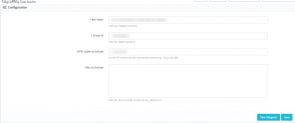

ANTONIOPS Posted November 22 Author Share Posted November 22 9 hours ago, Prestashop Addict said: Hi, I don't know module but if you have programmer skills you can make it see approach sample I actually created a small module before posting this that catches all HTTP codes and sends them to a Telegram group (it first retrieves all user information if the user is registered). I had to add a reference to a PHP file from my module inside the index.php file, just like in the example you mentioned. However, I find it a bit "messy" to modify that file. The module adds this line during installation and removes it upon uninstallation. Still, I don't think a module that modifies this file would be considered a good practice 😅. Here is the line added to index.php: require_once __DIR__ . '/modules/telegramhttcodenotifier/code_handler.php'; The problem is that I still cannot catch the exception message, only the code. Being able to capture the message would save me a lot of time. Example of a message sent to Telegram: HTTP Code: 500 Method: POST Date: 2024-11-21 19:11:56 URL: {full URL where the code was caught} Customer Type: Registered Customer ID: 123456 // Shows 'Guest' if not registered Customer Email: {customer email} IP: xxx.xxx.xxx.xxx I'll take a closer look to the approach you shared just in case. Thanks! Link to comment Share on other sites More sharing options...
