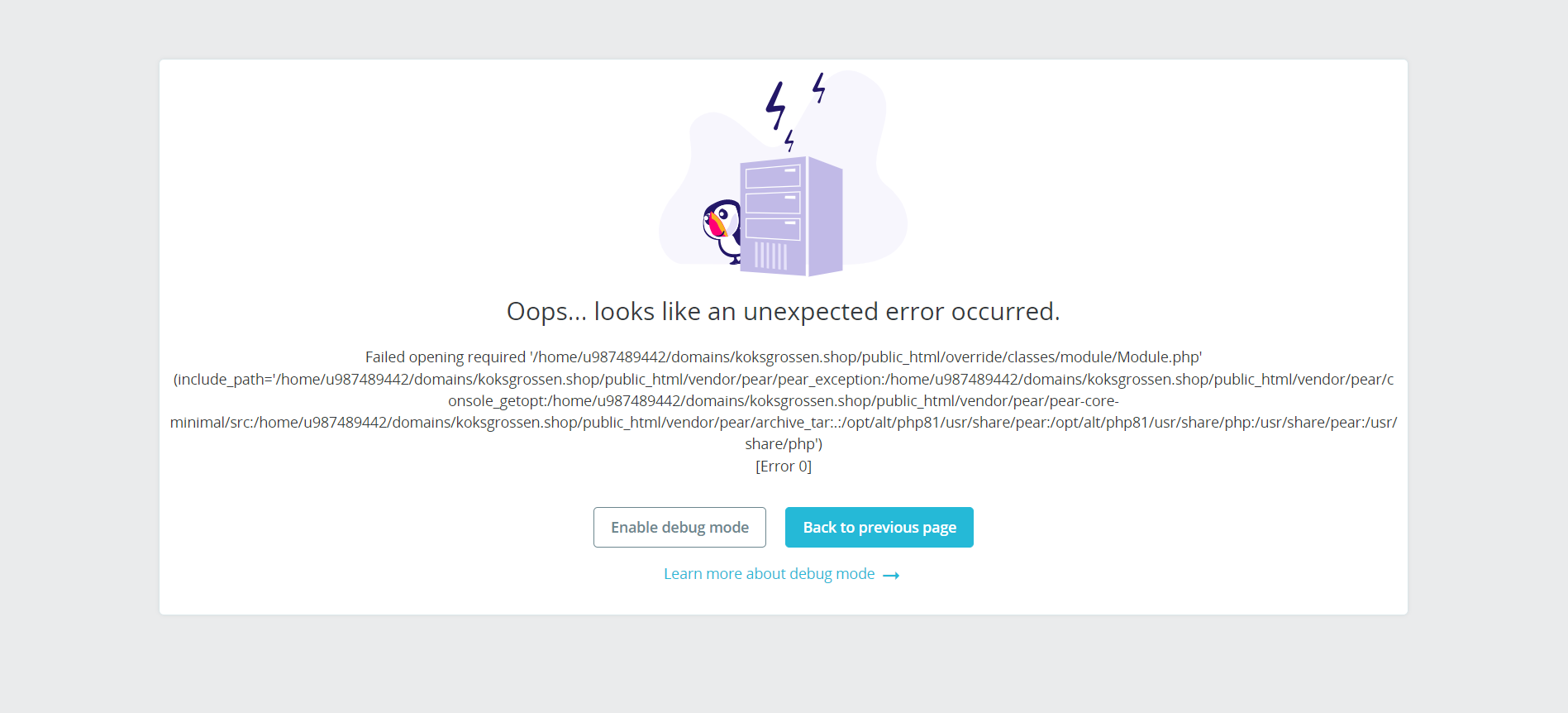

PrestaQvisten Posted October 8, 2024 Share Posted October 8, 2024 Hi, i have a problem that i don't know how to fix and hope some of you guys can help me with. A couple of days ago i updated my prestashop to 8.2.0 and the update procedure when fine. After the update I have som issue with my checkout page. I have bought two modules custom payment and one checkout. I activated debug mode i admin to see debug messages. I deactivated the modules after i got the debug message do see what to do and let the standard prestashop checkout be the main checkout. Day after that i did some other work on the page, update products and for some reason i needed to deactivate the debug mode in admin, i switched the debug mode off. After this action i get this error, see attached image. It's impossible to reach both frontpage and admin page. I don't know what to do, can somebody get me advice what to do? Login page gives me the message, see image attached and in the front i get a HTTP ERROR 500 I have tried to push to button enable the debug mode, but it won't work. Link to comment Share on other sites More sharing options...
Prestashop Addict Posted October 8, 2024 Share Posted October 8, 2024 You have an override missing file override/classes/module/Module.php try to delete file var/cache/prod/class_index.php Link to comment Share on other sites More sharing options...
PrestaQvisten Posted October 29, 2024 Author Share Posted October 29, 2024 On 10/8/2024 at 8:18 AM, Prestashop Addict said: You have an override missing file override/classes/module/Module.php try to delete file var/cache/prod/class_index.php Expand Hi, Is it safe to delete that file? Link to comment Share on other sites More sharing options...
Prestashop Addict Posted October 29, 2024 Share Posted October 29, 2024 Yes it will automatically rebuild with valid overrides Link to comment Share on other sites More sharing options...
