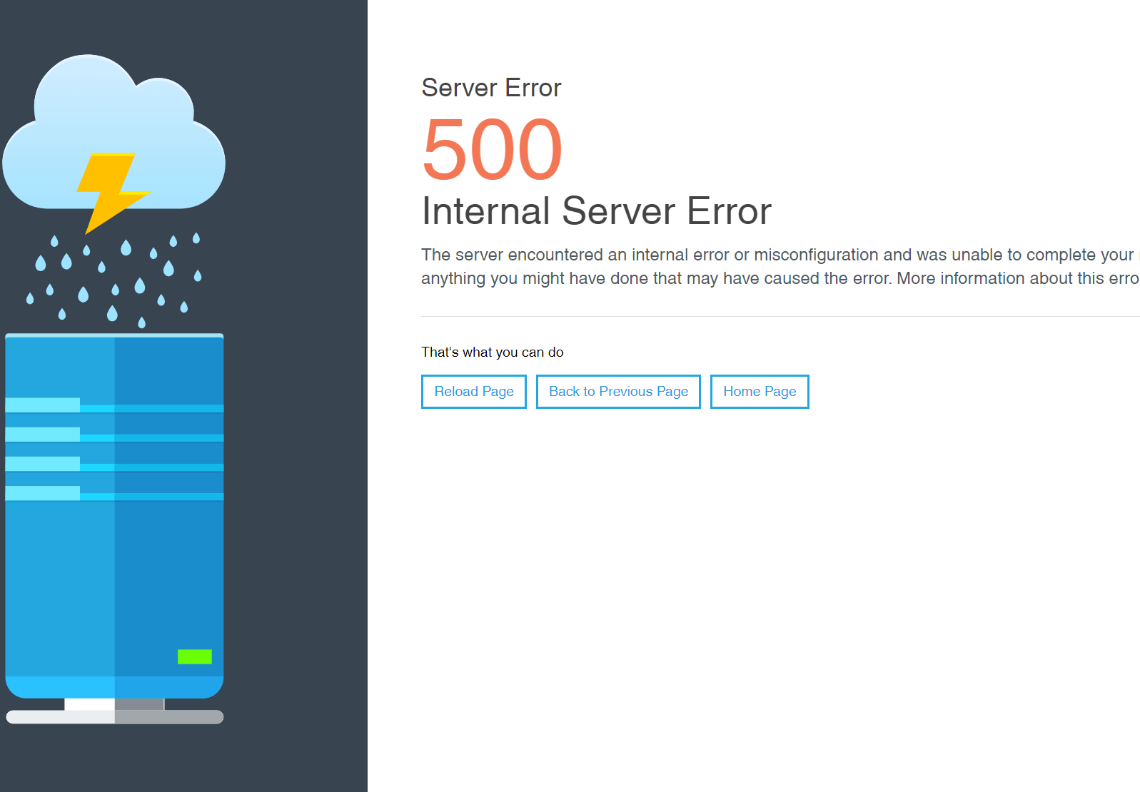

the_supermac Posted September 13, 2024 Share Posted September 13, 2024 Hi you all My backend returns me an error 500 when I click on Design/Positions... Frontend works apparently without problems. Theme is the standard Classic theme of PS, I maybe disabled some blocks in footer or somewhere else but using backend UI (not hard modifications directly on files) What can I do? (I have ftp access to server) Link to comment Share on other sites More sharing options...

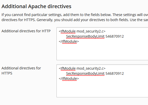

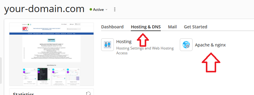

the_supermac Posted September 19, 2024 Author Share Posted September 19, 2024 Quote Make sure to go to cpanel or plesk panel whatever your using and click on Apache and nginx settings for your domain.com you are using and insert this code click apply . <IfModule mod_security2.c> SecResponseBodyLimit 546870912 </IfModule> insert it in your Additional directives for HTTP and HTTPS Thank you ps8modules but I can't find where to write that directive on my Plesk panel.... the only Apache related page shows me activated modules, no way to write anything here, so I tried to edit htaccess in site root adding that rows but it crashes entire front and backend (error 500).. Link to comment Share on other sites More sharing options...
ps8modules Posted September 19, 2024 Share Posted September 19, 2024 1 Link to comment Share on other sites More sharing options...
the_supermac Posted September 19, 2024 Author Share Posted September 19, 2024 GOTCHA! ps8modules I was accepting your private proposal then I seen your reply and tried autonomally (I wasn't aware of that settings in Plesk) It works, thank you a lot mate! 1 Link to comment Share on other sites More sharing options...

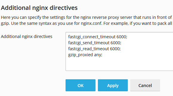

ps8modules Posted September 19, 2024 Share Posted September 19, 2024 (edited) I was happy to help 😉 It will certainly be good to increase other parameters in the same setting, at the very bottom. If you have a more powerful VPS, you can set more in the Additional HTTP/HTTP directives: <IfModule mod_fcgid.c> FcgidMaxRequestsPerProcess 500000 FcgidIOTimeout 300000 FcgidBusyTimeout 3600 FcgidMaxRequestLen 1073741824 FcgidProcessLifeTime 7200 FcgidMaxProcessesPerClass 40 FcgidIdleTimeout 30000 FcgidProcessLifeTime 30000 </IfModule> <IfModule mod_security2.c> SecRequestBodyLimit 2147483647 SecRequestBodyNoFilesLimit 2147483647 SecResponseBodyLimit 546870912 </IfModule> Edited September 19, 2024 by ps8modules (see edit history) 1 Link to comment Share on other sites More sharing options...
