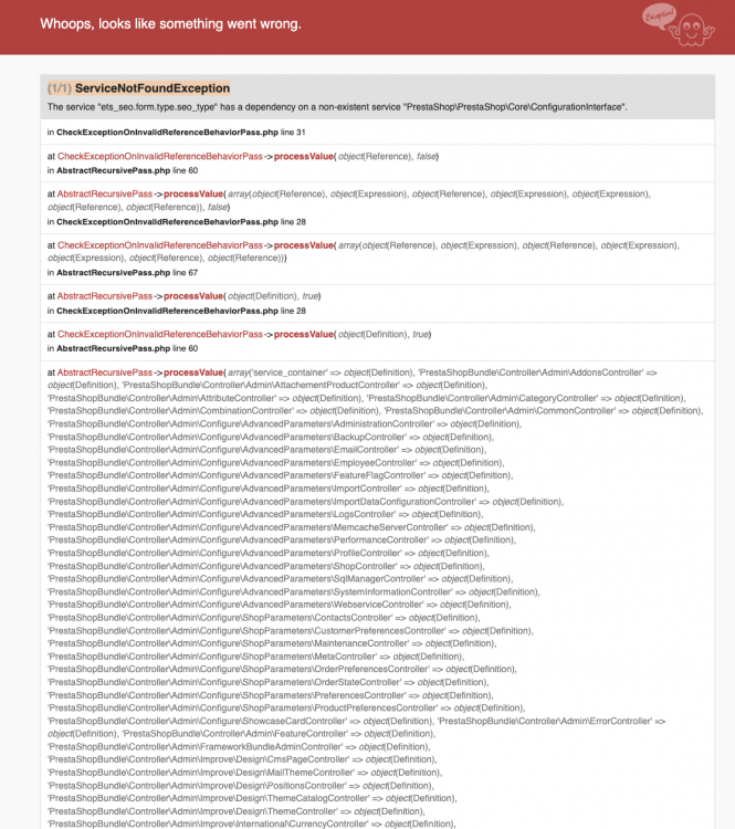

Maxflor Posted September 11, 2024 Share Posted September 11, 2024 Could someone please advise me? After updating the module, I cannot log in to the admin interface. The website queue is running fine and debug mode is showing me this error (1/1) ServiceNotFoundException. In the attachment, a sample of the error part of the screen. Thank you very much Link to comment Share on other sites More sharing options...

Tag Concierge Posted September 11, 2024 Share Posted September 11, 2024 The error states that the module ‘ets_seo’ has incorrectly registered the service in the dependency injection module. Here is a similar thread with an error in this module, maybe @ZHSoft can help you? Link to comment Share on other sites More sharing options...

ZHSoft Posted September 14, 2024 Share Posted September 14, 2024 On 9/12/2024 at 2:38 AM, Tag Concierge said: The error states that the module ‘ets_seo’ has incorrectly registered the service in the dependency injection module. Here is a similar thread with an error in this module, maybe @ZHSoft can help you? This is an error in the ets_seo module loading the template file, prompting that the template file does not exist and needs to be repaired by ets_seo. I guess this kind of problem usually occurs in high versions, and ets_seo needs to provide a module compatible with the new version. Link to comment Share on other sites More sharing options...
Maxflor Posted September 23, 2024 Author Share Posted September 23, 2024 already fixed, thank you module update fixed it. Link to comment Share on other sites More sharing options...
