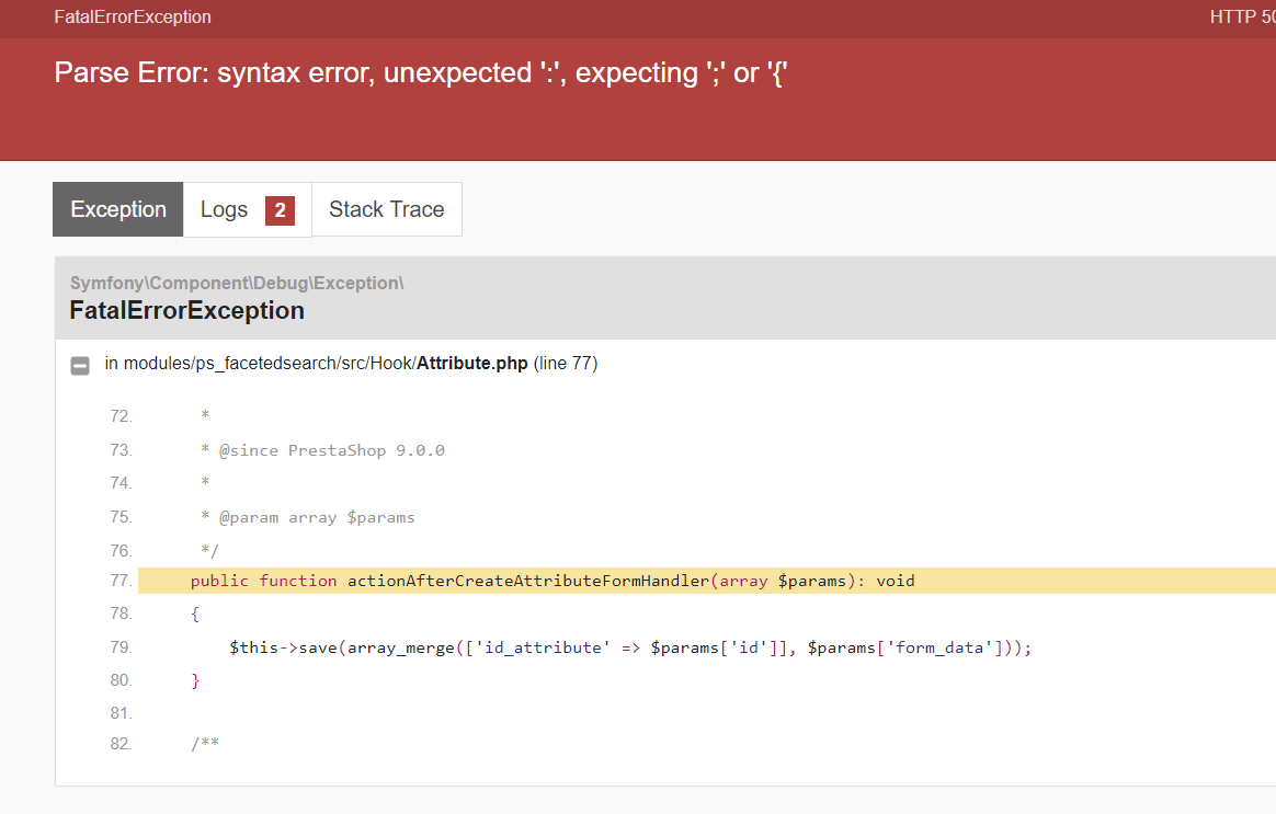

mykolas Posted September 9, 2024 Author Share Posted September 9, 2024 Thank you for the replies. At first I enabled the debug mode and after going into the categories through the website once again this was returned: (1/1) FatalErrorException Parse Error: syntax error, unexpected ':', expecting ';' or '{' in Attribute.php line 77 Is that an useful clue? Clearing cache did not help, I also did not find anything in the logs. I'll try the steps with phpMyAdmin as soon as I figure out how to use it. Link to comment Share on other sites More sharing options...

Paul C Posted September 9, 2024 Share Posted September 9, 2024 There are likely a few "Attribute.php" files (including in the override directory)! First step for me would be to locate the appropriate file and check what's at line 77... (for example, according to GitHub classes/Attribute.php Line 77 is in a function's DocBlock for 1.7.6.7). You can compare the files in your install with the ones in GitHub for your version: https://github.com/PrestaShop/PrestaShop/tree/1.7.6.7 As I said - that's not the only file with that name (ps_factedsearch has one in its src directory, for example) and you need to also check if there's anything of that name in the override directory. If there is, then you can rename it temporarily, clear the cache again (changes in that directory are only picked up at a cache clear) and test again. Rename back -> cache clear to restore it. I'm surprised you got a result from debug mode but everything is worth trying when it comes to PrestaShop.... 😀 Good Luck! Link to comment Share on other sites More sharing options...

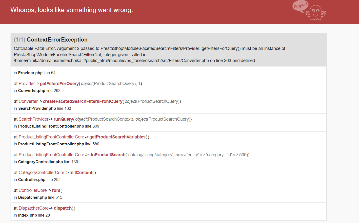

mykolas Posted September 9, 2024 Author Share Posted September 9, 2024 I edited the code a bunch of times with the errors that I received and since nothing seems to help and new errors are constantly popping up I am stopping at this one: Link to comment Share on other sites More sharing options...
Paul C Posted September 9, 2024 Share Posted September 9, 2024 What php version are you running? Nothing wrong with that syntax, assuming you're not running an outdated version of PHP. I think the recommendation is php 7.1 Link to comment Share on other sites More sharing options...

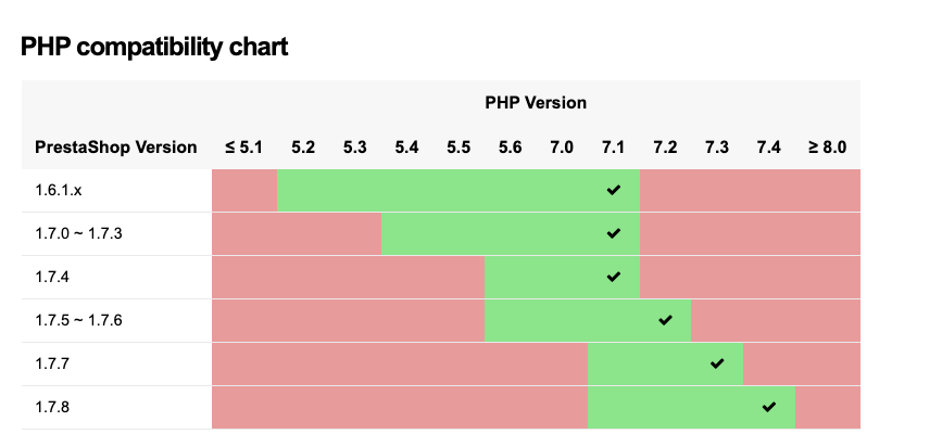

imjulien.dev Posted September 10, 2024 Share Posted September 10, 2024 Your Prestashop version will not support 7.4, you should use 7.2 or 7.1 version of PHP 1 Link to comment Share on other sites More sharing options...
Paul C Posted September 10, 2024 Share Posted September 10, 2024 (edited) 8 hours ago, mykolas said: I see that there are options of 7.4 ; 8.1 ; 8.2 ; 8.3 OK, you need v7.0+ if you're going to use that faceted search module and PHP 7.2 is what PrestaShop recommends for your version of PrestaShop (although 7.4 will *probably* work fine, maybe). The system requirements, including php versions can be found on this page and while it says that PHP 5.6 is compatible, that's only the core and doesn't include modules. The original error you got was because the faceted search module uses a new feature "return type declarations" (the : void at the end of line 77). Support for this was added in PHP 7 which is why you get that error - PHP 5.6 doesn't support it. These new language features are documented here. You can either remove modules which require PHP 7.0+ (such as the faceted search module, but there may be others), downgrade modules to older versions that work with PHP 5.6 or upgrade your PHP to version 7.2 (or maybe 7.4 if 7.2 isn't available on your server). PHP 8 isn't supported for your version of PrestaShop. I use PHP 8.1 for PrestaShop 8.1.x though, so upgrading may also be something you may want to consider. Edited September 10, 2024 by Paul C minor typo (see edit history) 1 Link to comment Share on other sites More sharing options...

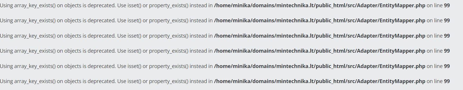

mykolas Posted September 10, 2024 Author Share Posted September 10, 2024 (edited) Yesterday I changed the php version to 7.4 and I got these messages in the debug mode so I thought it won't work and I turned it off, but then I turned it on the second time today and I noticed that the categories have fixed themselves, and in normal mode everything seems to be functioning normally, I'll wait and see if there is any other issues that appear from this, but for now thank you very much. (one thing I was also curious about, did I somehow trigger the code to update and not be able to work with 5.6 php? or is it more likely it just updated automatically?) Edited September 10, 2024 by mykolas (see edit history) 1 Link to comment Share on other sites More sharing options...
Paul C Posted September 10, 2024 Share Posted September 10, 2024 (edited) Those aren't errors just notices and they're fine. Fingers crossed it will work for you There's no link sadly between module version and shop version, so a module won't ever check what version of PHP you're running before an install or update. Ideally a module developer should update the details of which versions it works with (factoring in PHP compatibility), but sadly that just doesn't seem to happen..... PHP 5.6 is seriously old and hasn't been actively maintained for some time now. If you want to see how far behind PrestaShop 1.7 is with PHP then compare the system requirements link in my post above with the official PHP supported version list! There was no PHP 6 but even so, PHP 5 dropped off the list years ago..... EDIT: 5.6 was unsupported as of 5 years 8 months ago...... Edited September 10, 2024 by Paul C clarification of php 5.6 drop in support (see edit history) 1 Link to comment Share on other sites More sharing options...
