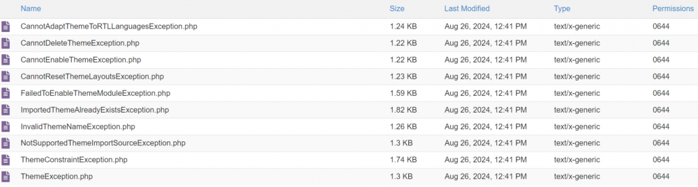

Nickz Posted August 27, 2024 Share Posted August 27, 2024 When looking thru the logs the failed to delete Profile/Exception/failedToDeleteProfileException.php. and Exception/FailedToEnableThemeModuleException.php. could be a rights related issue. Look up the permission section on the presta help. Did you set up the VPS yourself? Is the hostname set? VPS are not really straight forward, depends also on the distro and the permission settings. https://stackoverflow.com/questions/27753308/how-to-set-permissions-for-apache2-to-let-user-create-or-edit-files-in-var-www Link to comment Share on other sites More sharing options...

steve02cal Posted August 28, 2024 Author Share Posted August 28, 2024 Thank you.... I looked at line 6150 and this is what I saw: [2024-08-26 12:41:43] Copied /src/Core/Domain/Theme/Exception/FailedToEnableThemeModuleException.php. This shows it was a COPY statement. It appears to have copied successfully. Does not show an error. Am I not reading this correctly? That module shows permission of 0644 just as all the other modules. Here is a screenshot of that directory with all the modules: Link to comment Share on other sites More sharing options...
