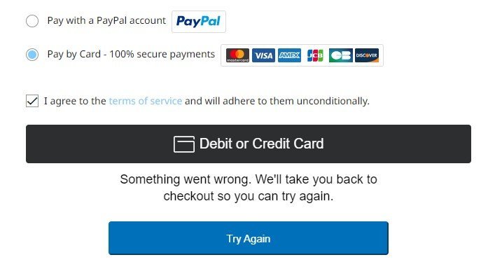

Creativebrain Posted August 17, 2024 Share Posted August 17, 2024 (edited) I installed the PrestaShop Checkout module and the Official PayPal module in my PrestaShop 8.1.7 and linked my PayPal (business) account. However, why every time I try to test a payment with my another Paypal (personal) account, both modules always gave me the same error "Sorry, something went wrong. Please try again." ? Which always redirect to this link : https://www.paypal.com/checkoutweb/genericError?code=REVGQVVMVA%3D%3D&cancelLink=&merchantName= WhatsApp Video 2024-08-17 at 11 (online-video-cutter.com) (online-video-cutter.com).mp4Fetching info... Someone suggested clearing the cache and cookies, which I did, but it still didn't work, even when I tried it in a different browser and even I tried to make another personal Paypal account, but still same. Then I tried twice with my credit cards, first with my Visa card and then with my Mastercard, but both attempts gave me the message: "Something went wrong. We'll take you back to checkout so you can try again". And I received notifications on my phone from my credit card issuers stating that the transactions failed. I have tried disconnecting my PayPal business account from my PrestaShop and connecting my PayPal personal account instead, but I still got the same error messages. So, what’s causing the error messages that prevent me from trying make payments? Is there something that needs to be configured on my PayPal account? I truly appreciate for your help, thank you. additional notes: I use Prestashop 8.1.7 that running on PHP 8.2 with Prestashop Checkout module 8.4.0.1 and Official Paypal module 6.4.2 I saw in error_logs there repeated error like these [16-Aug-2024 02:13:38 Asia/Jakarta] PHP Warning: Undefined array key "value" in /modules/ps_checkout/src/Webhook/WebhookEventConfigurationUpdatedHandler.php on line 64 [16-Aug-2024 10:55:11 Asia/Jakarta] PHP Warning: Trying to access array offset on value of type null in /modules/ps_checkout/src/PayPal/Order/CommandHandler/UpdatePayPalOrderCommandHandler.php on line 96 [16-Aug-2024 10:55:13 Asia/Jakarta] PHP Warning: Undefined array key "payment_source" in /ps_checkout/src/PayPal/Order/CommandHandler/SavePayPalOrderCommandHandler.php on line 64 Edited August 19, 2024 by Creativebrain add error_log (see edit history) Link to comment Share on other sites More sharing options...
