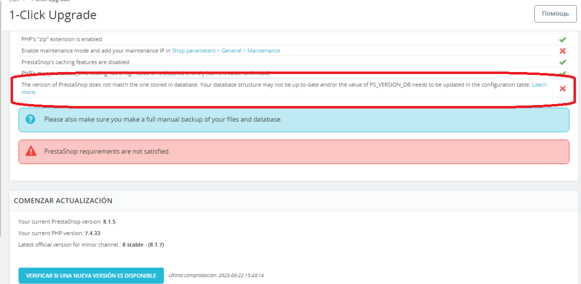

Toropov67 Posted July 3, 2024 Share Posted July 3, 2024 I ran into a problem for the first time. Can anyone tell me how to solve this problem? Link to comment Share on other sites More sharing options...
Nickz Posted July 3, 2024 Share Posted July 3, 2024 Do you have a back up? 1st step when updating. Then update to the next version, then the next till you get to the one you wish to use. Make sure you modules follow you. Link to comment Share on other sites More sharing options...

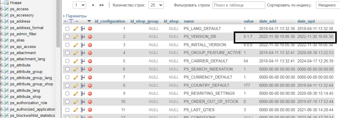

justmeagain Posted July 5, 2024 Share Posted July 5, 2024 Well 1st thing I'd do is click on Learn more and see what it says....then i'd have a look in my databast at what version number is showing compare it to the version you running and then go from there..... Link to comment Share on other sites More sharing options...
Toropov67 Posted July 6, 2024 Author Share Posted July 6, 2024 Thanks for the advice. Unfortunately, I don't have any backups.And from the provider's side, a copy is 1 month old. They didn't help.I have another website. In phpMyAdmin, I changed the version and date to the correct one. and updated it. Link to comment Share on other sites More sharing options...
