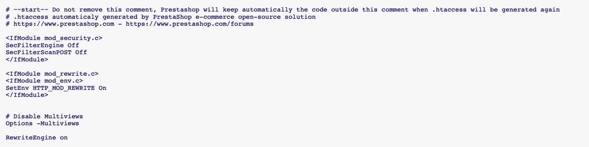

Prestashop Addict Posted June 11, 2024 Share Posted June 11, 2024 Vous pouvez publier le début de votre .htaccess la partie rules avant Presta voir si un module n'a pas ajouté des règles Link to comment Share on other sites More sharing options...
kerozenn Posted June 11, 2024 Author Share Posted June 11, 2024 Cette partie là? Link to comment Share on other sites More sharing options...
Prestashop Addict Posted June 11, 2024 Share Posted June 11, 2024 Pas de règles sous le RewriteEngine on ? c'est quoi l'url du site ? Link to comment Share on other sites More sharing options...
kerozenn Posted June 11, 2024 Author Share Posted June 11, 2024 (edited) Le voilà en entier merci! https://www.site.kerozenn.fr/kerozenn/ (site en maintenance pour le moment car le passage à la commande est trop long) # ~~start~~ Do not remove this comment, Prestashop will keep automatically the code outside this comment when .htaccess will be generated again # .htaccess automaticaly generated by PrestaShop e-commerce open-source solution # https://www.prestashop.com - https://www.prestashop.com/forums <IfModule mod_security.c> SecFilterEngine Off SecFilterScanPOST Off </IfModule> <IfModule mod_rewrite.c> <IfModule mod_env.c> SetEnv HTTP_MOD_REWRITE On </IfModule> # Disable Multiviews Options -Multiviews RewriteEngine on Edited June 11, 2024 by kerozenn (see edit history) Link to comment Share on other sites More sharing options...
