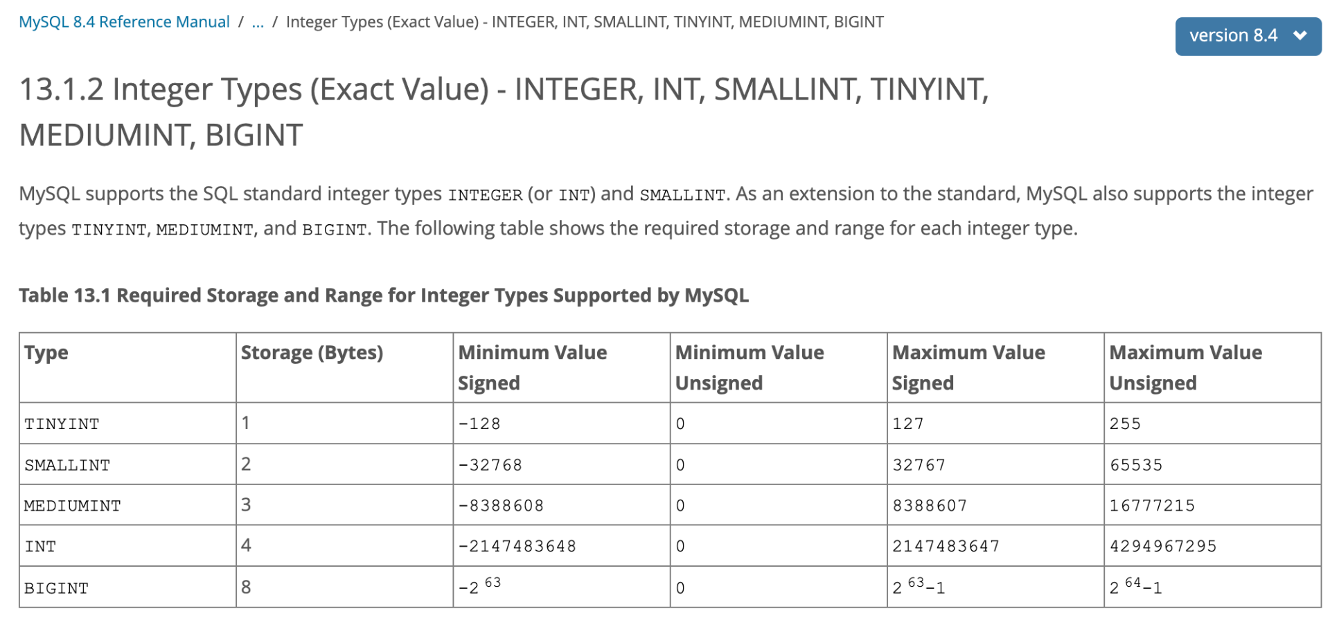

ZHSoft Posted June 5, 2024 Share Posted June 5, 2024 (edited) It depends on whether your field type is int or bigint. https://dev.mysql.com/doc/refman/8.4/en/integer-types.html Edited June 5, 2024 by ZHSoft (see edit history) Link to comment Share on other sites More sharing options...
Danmant_DK Posted June 5, 2024 Author Share Posted June 5, 2024 5 hours ago, ZHSoft said: It depends on whether your field type is int or bigint. https://dev.mysql.com/doc/refman/8.4/en/integer-types.html Thank you for your help As i am told, changing to BIGINT demands changing a lot of other stuff due to multilingual (danish) webshop and possible change with every update. Right? Link to comment Share on other sites More sharing options...

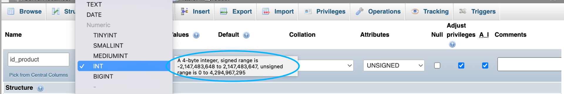

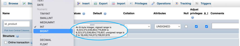

ZHSoft Posted June 6, 2024 Share Posted June 6, 2024 It doesn't need to be troublesome, but it's very simple: 1. Export your database as a text file through phpmyadmin. 2. Open the database file, find the int fields in it and replace them with bigint in batches 3. Save the above changes and re-import the database. End. Link to comment Share on other sites More sharing options...
Danmant_DK Posted June 6, 2024 Author Share Posted June 6, 2024 17 hours ago, ZHSoft said: It doesn't need to be troublesome, but it's very simple: 1. Export your database as a text file through phpmyadmin. 2. Open the database file, find the int fields in it and replace them with bigint in batches 3. Save the above changes and re-import the database. End. Thank you for your help I am sorry, but i am still confused 1) Export which product file? Is csv format okay? 2) Is it the ps_product file to be opened in "structure"? Is it the id_product line to be altered? In "datatype" i can change to bigint, but what is batches? 3) After re-importing the database, can i then import new products with a high id value as normal from BO? Do i need to make any changes after updating ps versions? Link to comment Share on other sites More sharing options...
ZHSoft Posted June 7, 2024 Share Posted June 7, 2024 1) Use phpmyadmin to export your database as a text file with a .sql suffix. It must be .sql. 2) You can find the corresponding tables in the structure one by one and change the bigint type, but this is too slow and inefficient. The batch method is as mentioned in 1). 3) This only changes all ints in the database to bigint, and does not affect any other functions. If you feel something is wrong after upgrading PS, do the method mentioned in 1) again. Link to comment Share on other sites More sharing options...
Danmant_DK Posted October 4, 2024 Author Share Posted October 4, 2024 On 6/7/2024 at 7:29 AM, ZHSoft said: 1) Use phpmyadmin to export your database as a text file with a .sql suffix. It must be .sql. 2) You can find the corresponding tables in the structure one by one and change the bigint type, but this is too slow and inefficient. The batch method is as mentioned in 1). 3) This only changes all ints in the database to bigint, and does not affect any other functions. If you feel something is wrong after upgrading PS, do the method mentioned in 1) again. Sorry for my late response I have downloaded the .sql database and opened it with Notepad++ Something went wrong and not all the data is present. Is Notepad++ not good for this purpose? Better suggestions? In which categories should i change the int to bigint? Only in id_product? Link to comment Share on other sites More sharing options...
