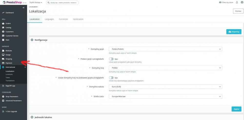

sylwekb Posted February 20 Share Posted February 20 (edited) Hello After updating Prestashop 1.7.8.11 to 8.1.4, the menu language is English even though the default language is Polish. The package appears to be installed correctly. What could be the reason. In some places, after going deeper, there are words in Polish. How can I solve this problem? Edited February 20 by sylwekb (see edit history) Link to comment Share on other sites More sharing options...
JBW Posted February 20 Share Posted February 20 I have seen this multiple times. During upgrade somehow entries in ps_tab_lang get removed/corrupted. Compare/restore the entries with the entries from previous backup 1 Link to comment Share on other sites More sharing options...
ComGrafPL Posted February 20 Share Posted February 20 Try with re-import localization. Saw it also few times. 1 Link to comment Share on other sites More sharing options...
sylwekb Posted February 20 Author Share Posted February 20 Thank you Indeed, restoring the table ps_tab_lang get from a backup solved the problem. I previously tried importing the language but it did not solve the problem. I looked through the this table inside and they were 3 times larger in only English. Most likely it was damaged during migration. Link to comment Share on other sites More sharing options...
