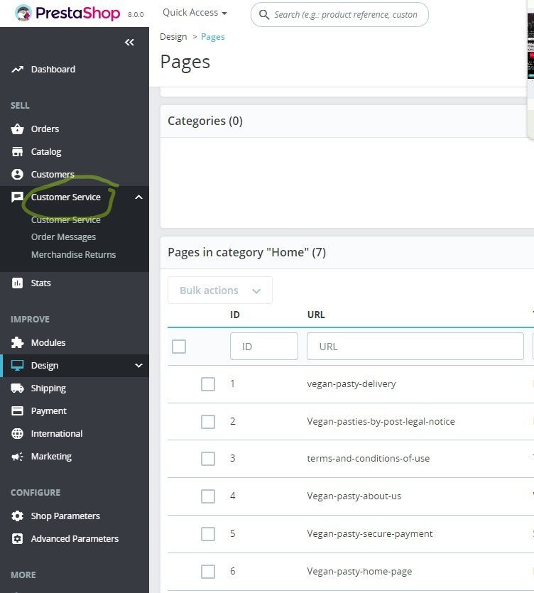

theveganpastycompany Posted February 19 Share Posted February 19 I have a recurring issue. Every time I press customer service in the customer service tab it crashes my website. It seems like something is wrong in the customer service tab but I can't get in to look at it without the page crashing. Does anyone have any suggestions on how to fix this? Or do I need to reset my site and start again? If so, how do I reset my site? Regards Steve Link to comment Share on other sites More sharing options...
corrigerunbug Posted February 19 Share Posted February 19 (edited) Hello Have you configured by mistake IMAP or POP configuration in Customer Service ? Best regards Edited February 19 by corrigerunbug (see edit history) Link to comment Share on other sites More sharing options...
theveganpastycompany Posted February 19 Author Share Posted February 19 Yes probably. Any idea how to fix this? Regards Steve Link to comment Share on other sites More sharing options...
corrigerunbug Posted February 19 Share Posted February 19 You need to look in database for that configuration and remove it you can look in table ps_configuration Link to comment Share on other sites More sharing options...
