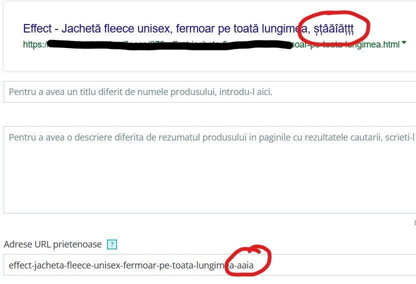

kokosmin Posted January 26, 2024 Share Posted January 26, 2024 Prestashop 1.7.7.8 The character deleted from title to URL is ”ț” and is not replaced with ”t”. The character successfully replaces now is ”ţ” which is the wrong character for Romanian and should not be not present in ro-RO character table or at least added with the ”ț”. I can see why it would be present, but it's an old variant used in Windows XP default fonts. To be clear, cedilla ț is not correct in Romanian https://en.wikipedia.org/wiki/Cedilla Link to comment Share on other sites More sharing options...

fishingnet Posted May 30, 2024 Share Posted May 30, 2024 I don't no why but i can't attach the file. So, I will explain below how to solve this: 1. Using an editor (eg. notepad++), create a blank file and paste the code below: <?php class Tools extends ToolsCore { public static function str2url($str) { static $array_str = []; static $allow_accented_chars = null; $str = str_replace(array('Ș', 'ș', 'Ț', 'ț'), array('S', 's', 'T', 't'), $str); static $has_mb_strtolower = null; if ($has_mb_strtolower === null) { $has_mb_strtolower = function_exists('mb_strtolower'); } if (!is_string($str)) { return false; } if (isset($array_str[$str])) { return $array_str[$str]; } if ($str == '') { return ''; } if ($allow_accented_chars === null) { $allow_accented_chars = Configuration::get('PS_ALLOW_ACCENTED_CHARS_URL'); } $return_str = trim($str); if ($has_mb_strtolower) { $return_str = mb_strtolower($return_str, 'utf-8'); } if (!$allow_accented_chars) { $return_str = Tools::replaceAccentedChars($return_str); } // Remove all non-whitelist chars. if ($allow_accented_chars) { $return_str = preg_replace('/[^a-zA-Z0-9\s\'\:\/\[\]\-\p{L}]/u', '', $return_str); } else { $return_str = preg_replace('/[^a-zA-Z0-9\s\'\:\/\[\]\-]/', '', $return_str); } $return_str = preg_replace('/[\s\'\:\/\[\]\-]+/', ' ', $return_str); $return_str = str_replace([' ', '/'], '-', $return_str); // If it was not possible to lowercase the string with mb_strtolower, we do it after the transformations. // This way we lose fewer special chars. if (!$has_mb_strtolower) { $return_str = Tools::strtolower($return_str); } $array_str[$str] = $return_str; return $return_str; } } 2. Save the file on your computer, choosing "PHP Hypertext Preprocessor" (.php) as type and name it "Tools". 3.Copy the saved file into "yourdomain.ro\override\classes\' 4. Go to BackOffice->Advanced parameters->Performance and clear cache. 5. Test your product url. That's it Link to comment Share on other sites More sharing options...
kokosmin Posted June 2, 2024 Author Share Posted June 2, 2024 I did this exactly like you instructed, but no chages. See attached file. Link to comment Share on other sites More sharing options...
fishingnet Posted June 2, 2024 Share Posted June 2, 2024 Try to deactivate and activate Friendly URL Also try to create a new product or page with title containing "ș" or "ț" and see the effect on generated friendly URL Link to comment Share on other sites More sharing options...
