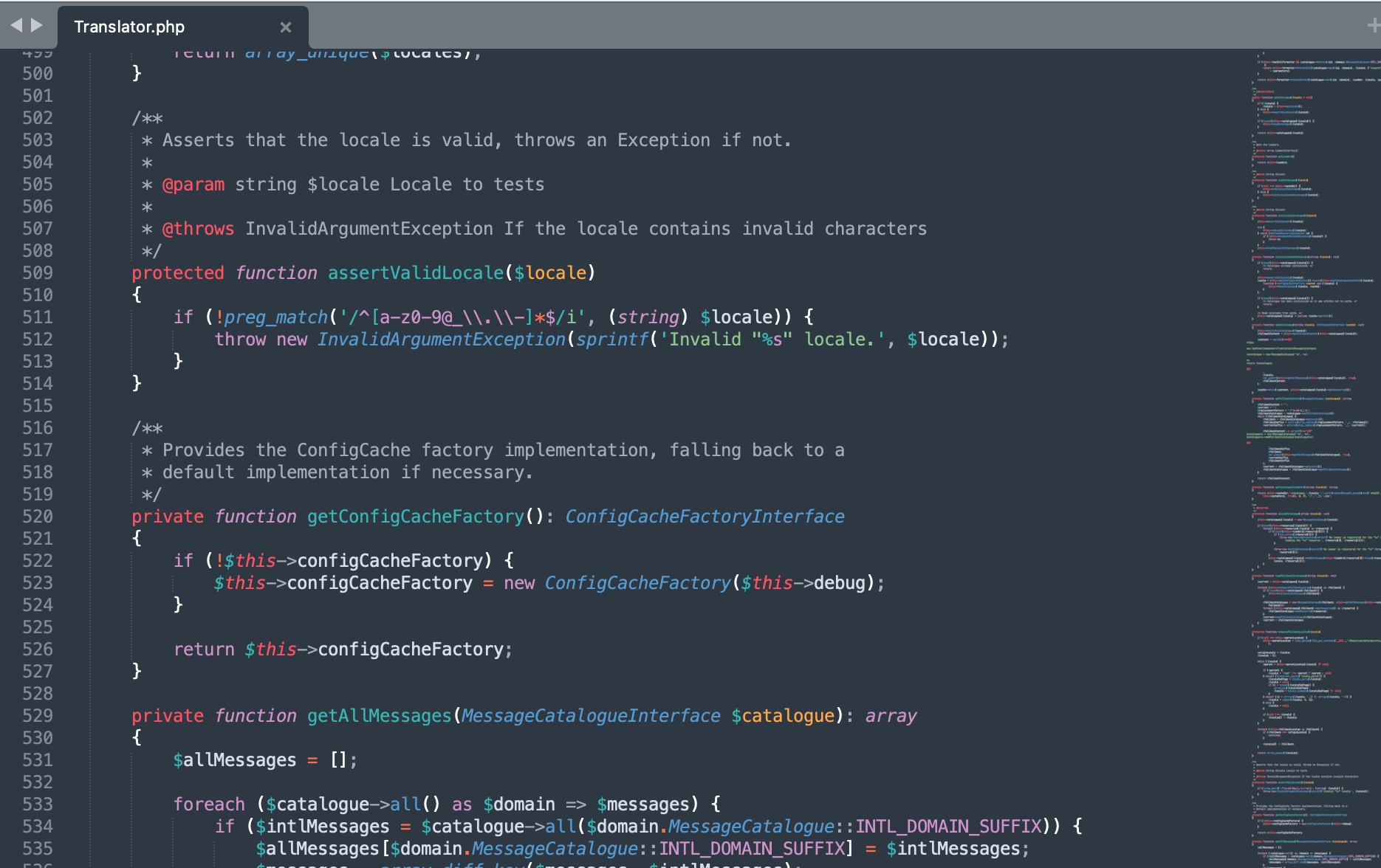

ifs-net Posted January 26, 2024 Share Posted January 26, 2024 I installed Prestashop 8.2 (clean installation) on cloudways servers. I faced 2 issues 1- Frontend was at maintenance mode just after installation 2- Backend was not accessible. Internal Server Error 500 First I disabled the maintenance mode from Database, as I am not able to login at backend. Than I opened a ticket to clodways. And they returned me telling that is prestashop error below. How can I fix that pls ? Support (Cloudways Ticketing System) Jan 26, 2024, 2:37 AM GMT+5 Hi, Hope this finds you well, We checked the issue and identified due the following error the issue occurs [2024-01-26 00:09:24] request.CRITICAL: Exception thrown when handling an exception (Symfony\Component\Translation\Exception\InvalidArgumentException: Invalid "it-IT" locale. at /home/402829.cloudwaysapps.com/kebkxtrhya/public_html/vendor/symfony/symfony/src/Symfony/Component/Translation/Translator.php line 512) {"exception":"[object] (Symfony\\Component\\Translation\\Exception\\InvalidArgumentException(code: 0): Invalid \"it-IT\" locale. at /home/402829.cloudwaysapps.com/kebkxtrhya/public_html/vendor/symfony/symfony/src/Symfony/Component/Translation/Translator.php:512)"} [] Could you please verify the following with the help of your developer: Verify that the locale "it-IT" is correctly configured in your PrestaShop settings. This typically involves checking the language and regional settings within the PrestaShop admin panel. Ensure that Symfony's translation component is properly configured to support the "it-IT" locale. This may involve checking configuration files within your PrestaShop installation or any custom Symfony configuration files you may have. If you're using an older version of Symfony, consider updating to a newer version. Compatibility issues with locales and other components may have been addressed in newer releases. Link to comment Share on other sites More sharing options...

Nickz Posted January 30, 2024 Share Posted January 30, 2024 On 1/26/2024 at 9:04 AM, ifs-net said: installed Prestashop 8.2 (clean installation) on cloudways servers. I faced 2 issues Expand On 1/26/2024 at 9:04 AM, ifs-net said: /Component/Translation/Translator.php line 512) {"exception":"[object] ( Expand Ok 2 things, First, where did that installation come from? What does the line 512 say? Link to comment Share on other sites More sharing options...
ifs-net Posted January 30, 2024 Author Share Posted January 30, 2024 On 1/30/2024 at 1:28 PM, Nickz said: Ok 2 things, First, where did that installation come from? What does the line 512 say? Expand thank you for your reply - I have dowloaded official zip form prestashop.com - The line 512 under "/public_html/vendor/symfony/symfony/src/Symfony/Component/Translation/translator.php" is like below throw new InvalidArgumentException(sprintf('Invalid "%s" locale.', $locale)); Link to comment Share on other sites More sharing options...
