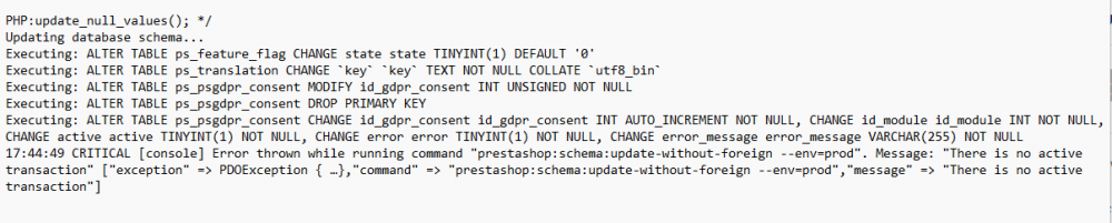

spielgigant Posted January 25, 2024 Share Posted January 25, 2024 I have updated my store via 1-Click-Update so that I am up to date with the latest patch status. I get an error with the 1-click update. What does this error mean? Can I read somewhere what can be done in such cases? I found this article https://github.com/PrestaShop/PrestaShop/issues/33021, which is supposed to be solved in 8.1.0. Version: PerstaShop Update von 8.1.1 auf 8.1.3 10.6.15-MariaDB - MariaDB Server PHP 8.2.12 Error: Error during database upgrade. You may need to restore your database. Error upgrading Doctrine schema Extract from the protocol: In Connection.php line 1854: There is no active transaction prestashop:schema:update-without-foreign [-h|--help] [-q|--quiet] [-v|vv|vvv|--verbose] [-V|--version] [--ansi] [--no-ansi] [-n|--no-interaction] [-e|--env ENV] [--no-debug] [--id_shop [ID_SHOP]] [--id_shop_group [ID_SHOP_GROUP]] [--] Link to comment Share on other sites More sharing options...
JBW Posted January 30, 2024 Share Posted January 30, 2024 The errors are related to change of database tables for psgdpr module. Double check the database if the changes are done correctly and completely. If not or in doubt your can reset/reinstall the module (you will loose its settings!) 1 Link to comment Share on other sites More sharing options...
spielgigant Posted February 18, 2024 Author Share Posted February 18, 2024 Hi @JBW Many thanks for the valuable advice. My test run was successful. Thanks a lot. Link to comment Share on other sites More sharing options...
