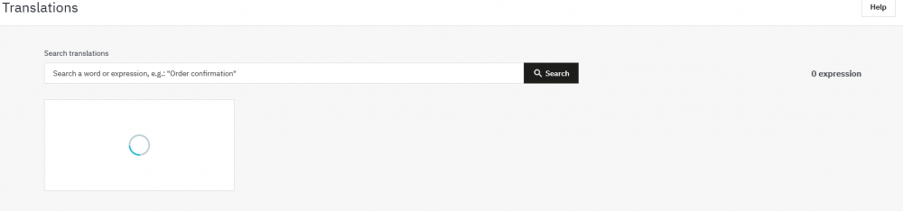

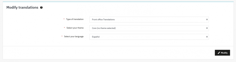

PeterGsson Posted January 16, 2024 Share Posted January 16, 2024 I downloaded PrestaShop 8.1.3 and installed. The installation was done in Swedish. Then English and Spanish were then installed. Some language changes have been made in the footer and products and are working. The problem is that Front Office translations do not work for English and Spanish, only in Swedish. I select "Front Office Translations" as well as the language (English or Spanish). On "Select your theme" I can't select anything, it just says "Core (no theme selected)". I click on "Modify" and I get to the page for translations and then in the upper right corner there is a small message with a red background that says "undefined". What could be the error and how to solve it? Sincerely Peter Link to comment Share on other sites More sharing options...

mavalentin Posted December 10, 2024 Share Posted December 10, 2024 I have been able to find the issue for my specific situation: I was overriding in my theme a .tpl file of a module, which was using a single digit as a key: {l s='0' d='Modules.Smartblog.Posts'}. As this is is not allowed, I tried to override the .tpl file in my theme and removing this translation, which was anyway useless for translating a 0, but it was not working, still. I had to remove this translation directive also in the original module file, I guess because the Prestashop Translation scanner was scanning also the original module folder and got stuck at that point. After removing it also from the original file, the problem did not happen anymore. Link to comment Share on other sites More sharing options...
