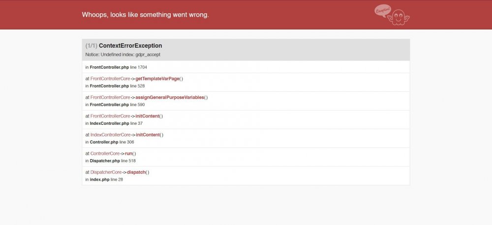

Sil_888 Posted January 3 Share Posted January 3 Hello, today I opened the website and I had this error (attachment), with the debug mode forcefully activated. I tried deactivating the gdpr module (Official GDPR Compliace by prestashop) but it doesn't change anything. Can anyone help me? Link to comment Share on other sites More sharing options...
QuickUpdate.net Posted January 3 Share Posted January 3 It's a "Notice", not an error so it will not affect the functionality of the website (without debug mode) Link to comment Share on other sites More sharing options...

Sil_888 Posted January 4 Author Share Posted January 4 No new module has been installed recently. I disinstalled the GDPR module and commented the error. It fixed the visualization issue, but i can't seem to deactivate debug mode. Do you have any suggestions? I tried to deactivate the module ps_account but it didn't worked. Link to comment Share on other sites More sharing options...
QuickUpdate.net Posted January 4 Share Posted January 4 Debug mode you deactivate from /config/defines.inc.php file Link to comment Share on other sites More sharing options...
