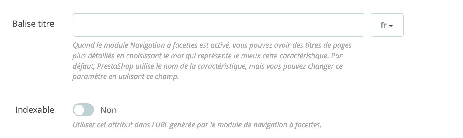

Mediacom87 Posted December 23, 2023 Share Posted December 23, 2023 Bonjour, Peut-être rependre la configuration de vos caractéristiques : Link to comment Share on other sites More sharing options...
Mediacom87 Posted December 23, 2023 Share Posted December 23, 2023 Pardon, cela ne touche pas le produit lui-même. Link to comment Share on other sites More sharing options...
