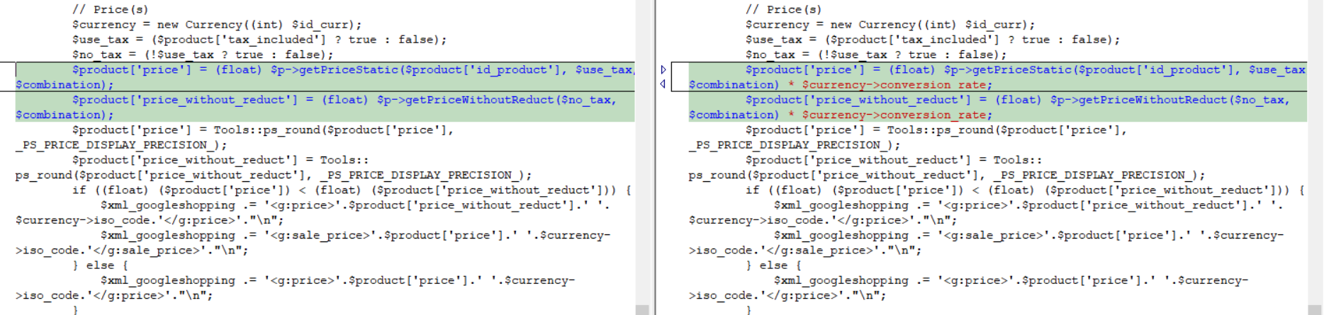

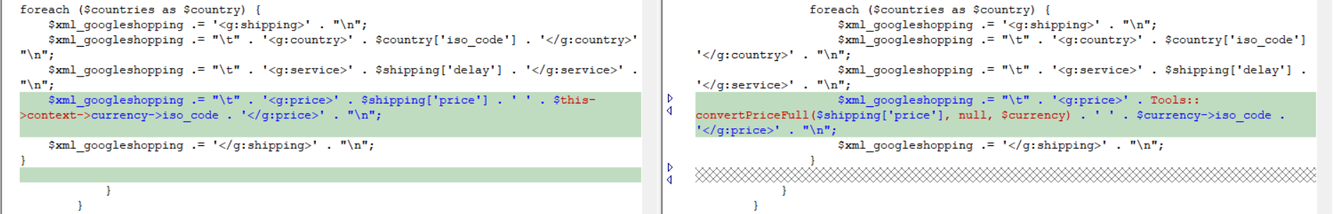

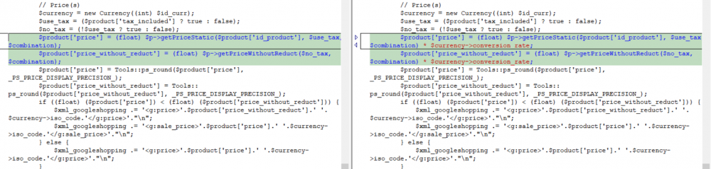

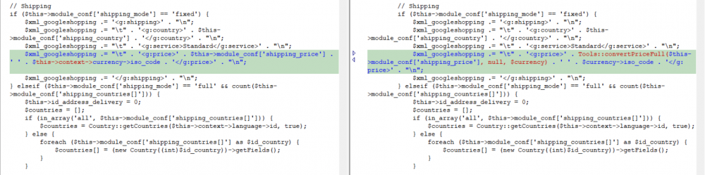

kamppa Posted June 19, 2024 Share Posted June 19, 2024 (edited) The official Google Marketing by Prestashop is a free module. There is no setting to send products without EAN. I switched to using excellent free module Google Shopping Flux which also works with Prestashop 8.1:https://github.com/d1m007/gshoppingflux I made minor changes to code so that it works perfectly with Multistore and different currencies. // Price(s) $currency = new Currency((int) $id_curr); $use_tax = ($product['tax_included'] ? true : false); $no_tax = (!$use_tax ? true : false); $product['price'] = (float) $p->getPriceStatic($product['id_product'], $use_tax, $combination); $product['price_without_reduct'] = (float) $p->getPriceWithoutReduct($no_tax, $combination); $product['price'] = Tools::ps_round($product['price'], _PS_PRICE_DISPLAY_PRECISION_); $product['price_without_reduct'] = Tools::ps_round($product['price_without_reduct'], _PS_PRICE_DISPLAY_PRECISION_); if ((float) ($product['price']) < (float) ($product['price_without_reduct'])) { $xml_googleshopping .= '<g:price>'.$product['price_without_reduct'].' '.$currency->iso_code.'</g:price>'."\n"; $xml_googleshopping .= '<g:sale_price>'.$product['price'].' '.$currency->iso_code.'</g:sale_price>'."\n"; } else { $xml_googleshopping .= '<g:price>'.$product['price'].' '.$currency->iso_code.'</g:price>'."\n"; } // Shipping if ($this->module_conf['shipping_mode'] == 'fixed') { $xml_googleshopping .= '<g:shipping>' . "\n"; $xml_googleshopping .= "\t" . '<g:country>' . $this->module_conf['shipping_country'] . '</g:country>' . "\n"; $xml_googleshopping .= "\t" . '<g:service>Standard</g:service>' . "\n"; $xml_googleshopping .= "\t" . '<g:price>' . $this->module_conf['shipping_price'] . ' ' . $this->context->currency->iso_code . '</g:price>' . "\n"; $xml_googleshopping .= '</g:shipping>' . "\n"; } elseif ($this->module_conf['shipping_mode'] == 'full' && count($this->module_conf['shipping_countries[]'])) { $this->id_address_delivery = 0; $countries = []; if (in_array('all', $this->module_conf['shipping_countries[]'])) { $countries = Country::getCountries($this->context->language->id, true); } else { foreach ($this->module_conf['shipping_countries[]'] as $id_country) { $countries[] = (new Country((int)$id_country))->getFields(); } } foreach ($countries as $country) { $xml_googleshopping .= '<g:shipping>' . "\n"; $xml_googleshopping .= "\t" . '<g:country>' . $country['iso_code'] . '</g:country>' . "\n"; $xml_googleshopping .= "\t" . '<g:service>' . $shipping['delay'] . '</g:service>' . "\n"; $xml_googleshopping .= "\t" . '<g:price>' . $shipping['price'] . ' ' . $this->context->currency->iso_code . '</g:price>' . "\n"; $xml_googleshopping .= '</g:shipping>' . "\n"; } } } You can use the same feed.xml with Facebook marketing. Edited June 19, 2024 by kamppa (see edit history) Link to comment Share on other sites More sharing options...
