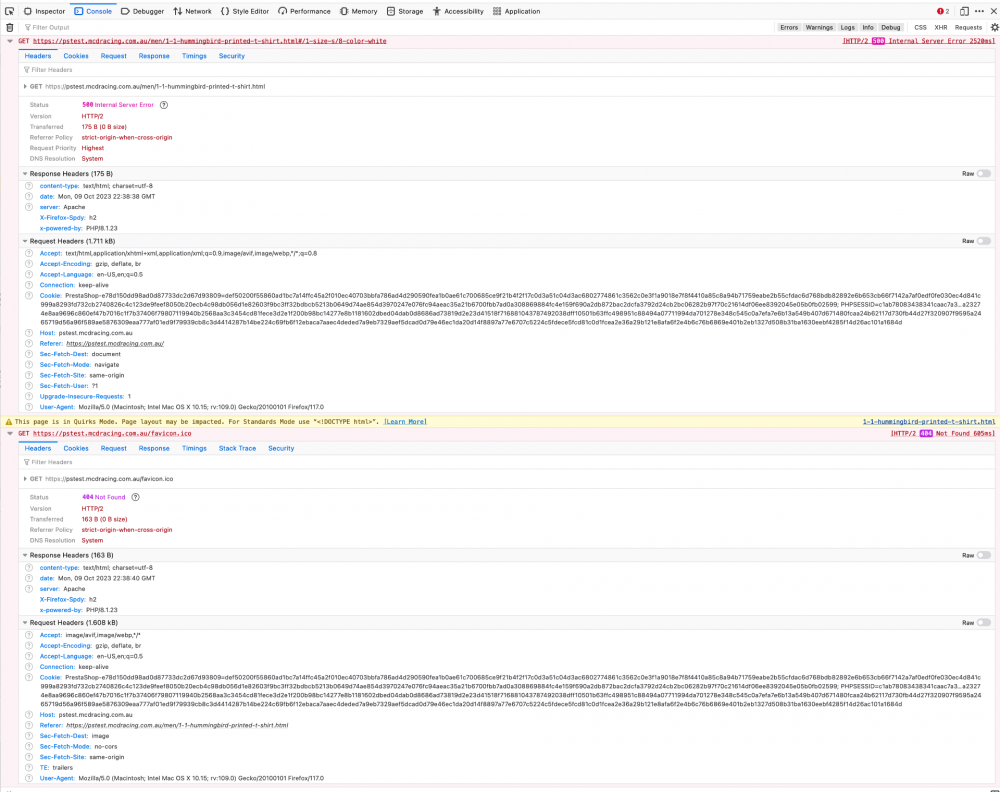

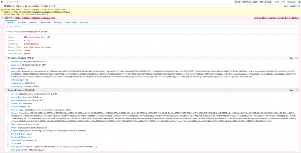

BeatsMe Posted October 9, 2023 Share Posted October 9, 2023 (edited) Ok... I have a test site that I'm testing the install of ps8.1 I have installed ps8.1.0 using the Inmotion Prestashop scripts. This is the demo shop that installs as default. Changed nothing, except to enter the required parameters for the Bank transfer to work. Using the default user (JOHN DOE) to test with. Can add items to the cart and place an order. Seems to be working ok. Then.... Have installed 1-Click Upgrade, and upgraded shop to ps8.1.2 After upgrade is complete, ADD TO CART button no longer works. Have changed nothing, other than to upgrade to current ps version. I have read about problems with Javascript, but cannot work out what the console is reporting. As said above this is a raw default install that I'm testing with and not getting anywhere with even the demo shop. Default theme, no changes.... I'm starting to lose hair because of this!! Any help would be greatly appreciated. Running... Server information: Linux #1 SMP Wed Aug 24 21:31:23 UTC 2022 x86_64 Server software version: Apache PHP version: 8.1.23 Memory limit: 512M Max execution time: 1000 Upload Max File size: 256M Edited October 9, 2023 by BeatsMe (see edit history) Link to comment Share on other sites More sharing options...

BeatsMe Posted October 9, 2023 Author Share Posted October 9, 2023 Hi AddWeb Solution.... Forgot to add the screenshot. Have added now, this is after clicking on ADD TO CART. Link to comment Share on other sites More sharing options...
BeatsMe Posted October 9, 2023 Author Share Posted October 9, 2023 If i try to reload the same page, without clearing cache, it shows this.... Link to comment Share on other sites More sharing options...
BeatsMe Posted October 9, 2023 Author Share Posted October 9, 2023 After clearing... Cookies and Site Data plus Cached Web Content The page reloads as normal, with no errors. Link to comment Share on other sites More sharing options...
