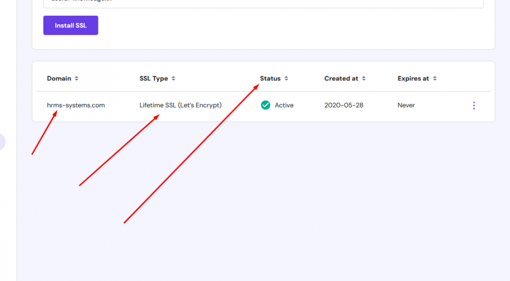

Zohaib-fk Posted October 16, 2023 Share Posted October 16, 2023 You can check from your web hosting Cpanel, SSL status. It will help to know whether the issue is from SSL from web hosting or the PS web application side. The different troubleshooting steps help to know the root cause of the issue and find the solution. Attached is a screenshot for your reference. You can check your website in the online tool if it is working for visitors from all over the world using the tools below. [1]. https://gtmetrix.com/ [2]. https://tools.pingdom.com/ Link to comment Share on other sites More sharing options...
