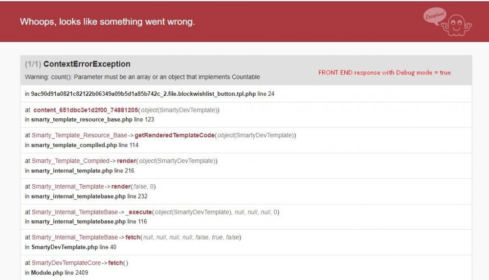

kibiribi Posted October 4, 2023 Share Posted October 4, 2023 (edited) Hi community! I've got PS 1.7.6.1 and started migration from one server to new one. PHP ver. for my old server = 7.2.34 PHP ver. for my new server = 7.2.34 (was installed for compatibility by me) I've faced with Backend login. Frontend works fine Backend got me 500 error. When I set define('_PS_MODE_DEV_', TRUE); - Backend works good, but frontend shows me a lot of internal errors. But when I change setting to define('_PS_MODE_DEV_', FALSE); BackEnd got an error 500, and Frontend operates good. I tried to change PHP ver. from 7.1.33 to 7.4.33 - situation all the same. I'm afraid to upgrade PS version because of my custom version of the Template. Could you advise - any solution for this ? Is it possible to activate Debug mode only for Backend ? :-) In this case I can run Backend and run FronEnd without debug mode. Thanks for your time and advices! Edited October 5, 2023 by kibiribi (see edit history) Link to comment Share on other sites More sharing options...
Mediacom87 Posted October 4, 2023 Share Posted October 4, 2023 (edited) Hi, You won't get this error with PHP 7.1, since count() is typical of incompatibility with PHP 7.2 and higher. In any case, it's essential to correct these errors. Perhaps a simple update of the modules would be enough to make the error disappear, otherwise you'll have to change the code. Edited October 4, 2023 by Mediacom87 (see edit history) 1 Link to comment Share on other sites More sharing options...
