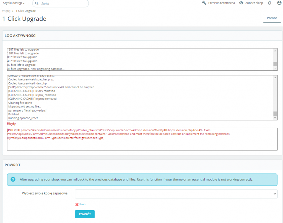

Tomi14 Posted October 2, 2023 Share Posted October 2, 2023 For the past few weeks, I've been trying to update the store to a newer version. I'm updating/disabling/removing various modules and changing the target version. I can't seem to find a solution. The message I receive when trying to update from 1.7.8.7 -> 1.7.8.10 Link to comment Share on other sites More sharing options...

Tomi14 Posted October 17, 2023 Author Share Posted October 17, 2023 Fixed. Restoring the /SRC folder from old backup from 2022 (Prestashop 1.7.8.2, I think) to the one from 1.7.8.7 helped. After restoring, the problem disappeared and the store was updated to 1.7.8.10 without any problems Regards Link to comment Share on other sites More sharing options...
