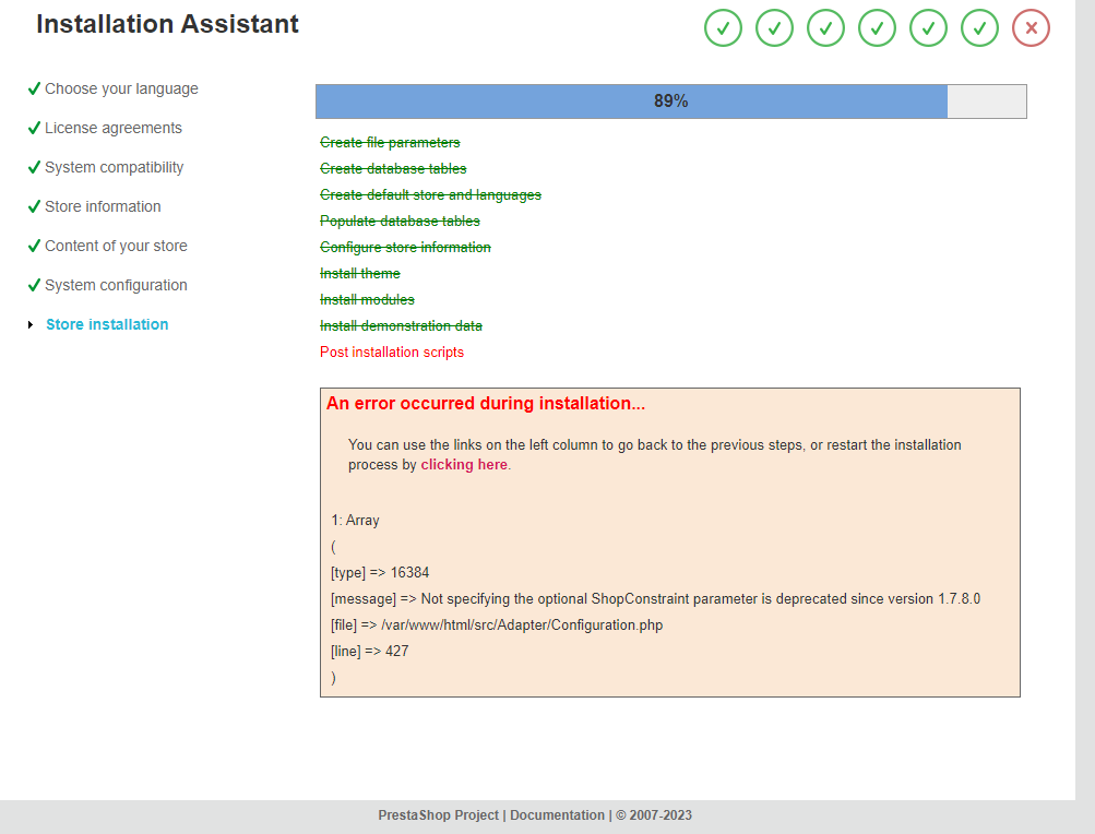

I'm trying to install PrestaShop 8.1.0 from source after downloading the release and moving the source code to my Linux based VM. I built a Dockerfile to containerize everything based on the official Dockerfiles in the PrestaShop Docker repo and some examples I found online to help get me started (will put it below, as it could be a configuration issue).
This is the error I'm getting:
I see no place to set the ShopConstraint and I'm not sure this is an ENV I set during containerization or if I need to just add a ShopConstraint somewhere in the code itself. Since I can't get passed this it's currently making me unable to actually do anything and start playing around with PrestaShop to do what I need to with my organization. It's throwing an error on this (1)  line in that file, presumably called from (2)

Any ideas?
