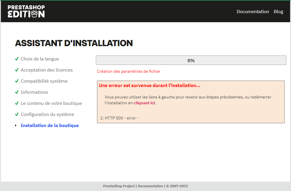

Faissal Bk Posted September 5, 2023 Share Posted September 5, 2023 I'm new here and i'm trying to install prestashop version 8.1.0 locally on my machine, i installed before wamp version 3.3.0 PHP version 8.0.26 all steps seems to be fine, but when the store start the installation it stucks on 0% in the first step ( creat file parameters) with the following error message: An error occurred during installation... You can use the links on the left column to go back to the previous steps, or restart the installation process by clicking here. 1: HTTP 500 - error - do you have any suggestion please ! Link to comment Share on other sites More sharing options...

endriu107 Posted September 8, 2023 Share Posted September 8, 2023 Turn on debug mode it will give you more details about error. Link to comment Share on other sites More sharing options...
Ophelina Posted September 9, 2023 Share Posted September 9, 2023 Thank you endriu107, I could identify the error, it was caused by a wrong OPENSSL_CONF configuration. Now it's OK and I have a new Prestashop installed on my computer 🤪 Now I pray Prestashop Team to add this step in installation guide please, to avoid future newbies like me wasting a lot of time. Regards Link to comment Share on other sites More sharing options...
mn95 Posted September 13, 2023 Share Posted September 13, 2023 On 9/9/2023 at 11:23 AM, Ophelina said: Thank you endriu107, I could identify the error, it was caused by a wrong OPENSSL_CONF configuration. Now it's OK and I have a new Prestashop installed on my computer 🤪 Now I pray Prestashop Team to add this step in installation guide please, to avoid future newbies like me wasting a lot of time. Regards Could you share your solution? What exactly did you do? What did the OPENSSL_CONF configuration steps look like? I got the same error ... Link to comment Share on other sites More sharing options...
musicmaster Posted September 23, 2023 Share Posted September 23, 2023 On 9/13/2023 at 2:52 PM, mn95 said: Could you share your solution? What exactly did you do? What did the OPENSSL_CONF configuration steps look like? I got the same error ... OPENSSL_CONF is a Windows environment variable. It points to an openssl.cnf file. Xampp is supposed to set that but it doesn't. Older Prestashop versions didn't check for that. If you have a standard Xampp installation its value should be C:\xampp\apache\bin\openssl.cnf. You can set the variable by pressing windows key+R, then filling in sysdm.ctl. You get then the System properties window. Choose the Advanced tab and on that page you find a button for environment variables at the bottom. For me it didn't work immediately. You may need to restart. Link to comment Share on other sites More sharing options...

mn95 Posted September 25, 2023 Share Posted September 25, 2023 On 9/23/2023 at 6:02 PM, musicmaster said: OPENSSL_CONF is a Windows environment variable. It points to an openssl.cnf file. Xampp is supposed to set that but it doesn't. Older Prestashop versions didn't check for that. If you have a standard Xampp installation its value should be C:\xampp\apache\bin\openssl.cnf. You can set the variable by pressing windows key+R, then filling in sysdm.ctl. You get then the System properties window. Choose the Advanced tab and on that page you find a button for environment variables at the bottom. For me it didn't work immediately. You may need to restart. Thank you, it works for me! Restart is necessary. Link to comment Share on other sites More sharing options...
