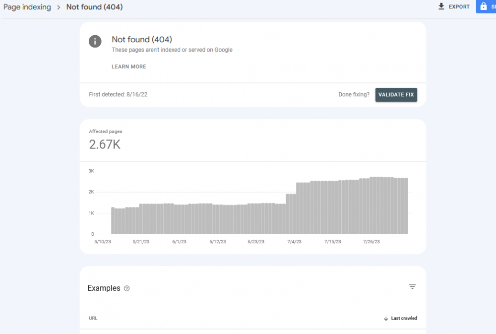

nasimparsi Posted August 22, 2023 Share Posted August 22, 2023 (edited) Hello friends. These 404 errors seem to exist by default in PrestaShop 1.7.7.8 and 1.7.8.9. Our two sites have thousands of errors in Google Webmaster, which are with this link: https://domain.com/2110-large_default/ Please guide me what is the problem? Edited August 22, 2023 by nasimparsi (see edit history) Link to comment Share on other sites More sharing options...
ComGrafPL Posted August 22, 2023 Share Posted August 22, 2023 Are the link to the images or the category / products? 1 Link to comment Share on other sites More sharing options...
nasimparsi Posted August 22, 2023 Author Share Posted August 22, 2023 3 hours ago, ComGrafPL said: Are the link to the images or the category / products? It is not clear what it is. Although it appears to be a photo. Nearly 3000 error 404 links have been registered in Google Webmaster. I have 2 prestashop sites. These are sample links from these two sites: 1- https://echista.ir/2404-large_default/3-https://echista.ir/5123-large_default/https://echista.ir/218-large_default/ 2- https://efarvahar.ir/aux-cable/390-https://efarvahar.ir/1666-large_default/40-https://efarvahar.ir/2106-large_default/ Link to comment Share on other sites More sharing options...

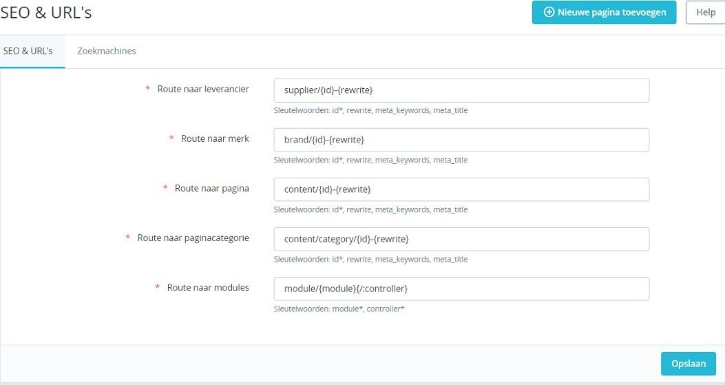

musicmaster Posted August 27, 2023 Share Posted August 27, 2023 I see that I made a typo, writing "large-default" instead of "large_default". And that one is present. What may be the problem is that you didn't renew your .htaccess. Go in the backoffice to the Settings-Seo&Urls page and press Save below the following part of the page (the picture is the Dutch version, but you will get the point): 1 Link to comment Share on other sites More sharing options...

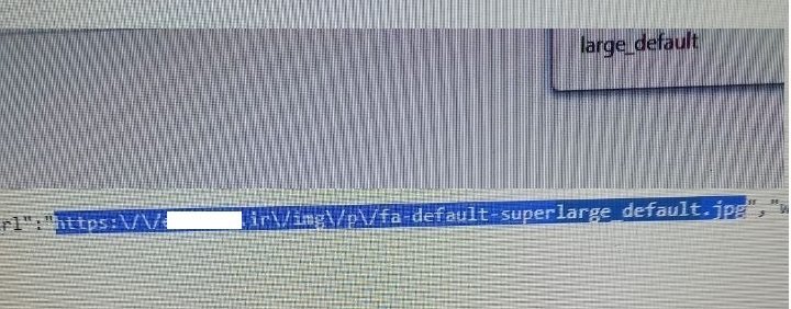

nasimparsi Posted August 31, 2023 Author Share Posted August 31, 2023 On 8/27/2023 at 12:31 PM, musicmaster said: I see that I made a typo, writing "large-default" instead of "large_default". And that one is present. What may be the problem is that you didn't renew your .htaccess. Go in the backoffice to the Settings-Seo&Urls page and press Save below the following part of the page (the picture is the Dutch version, but you will get the point): I realized that maybe the problem is the Structured Data Json code in the Product page. Can you see the picture? This code has created many links that Google Webmaster recognizes as 404 thank you Link to comment Share on other sites More sharing options...
