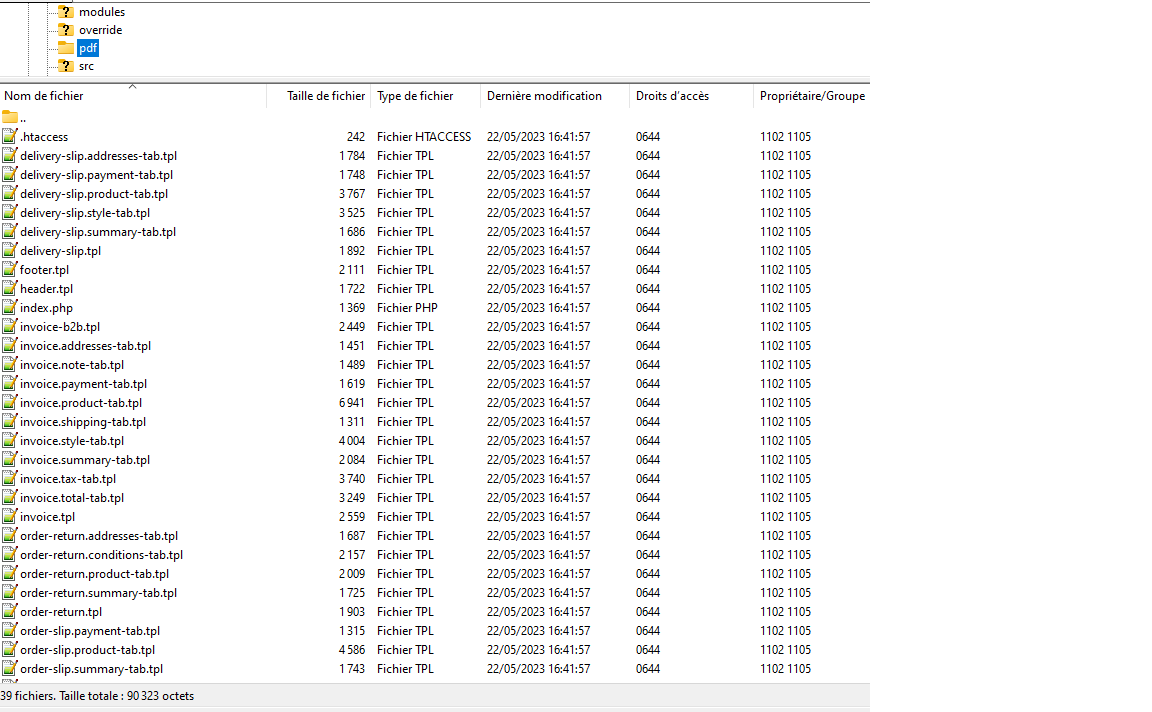

arm15 Posted August 22, 2023 Author Share Posted August 22, 2023 Je ne vois pas ou ça se trouve. Le chemin est bien \pdf ? Je vous joins un screenshot Link to comment Share on other sites More sharing options...
wepresta Posted August 22, 2023 Share Posted August 22, 2023 56 minutes ago, wepresta said: Classes/pdf classes/pdf 😁 Link to comment Share on other sites More sharing options...
