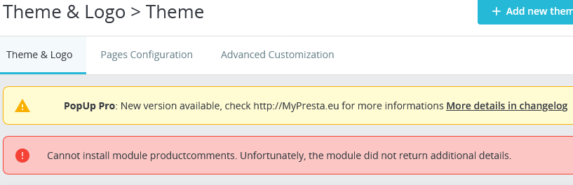

Ive tried numerous times to update from 1.7.8.10 to 8.1.1 and it install fails every time.

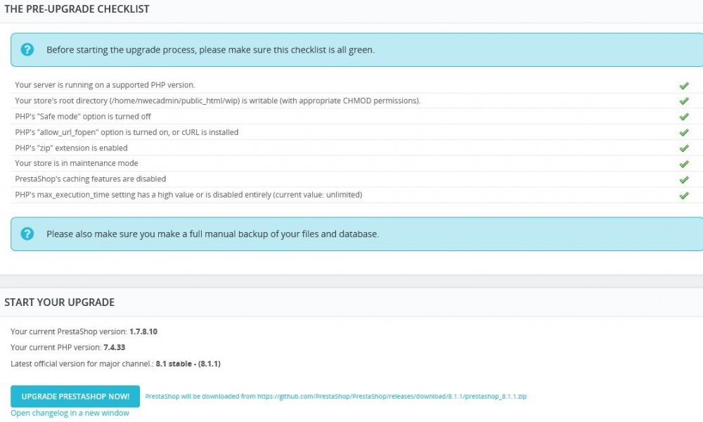

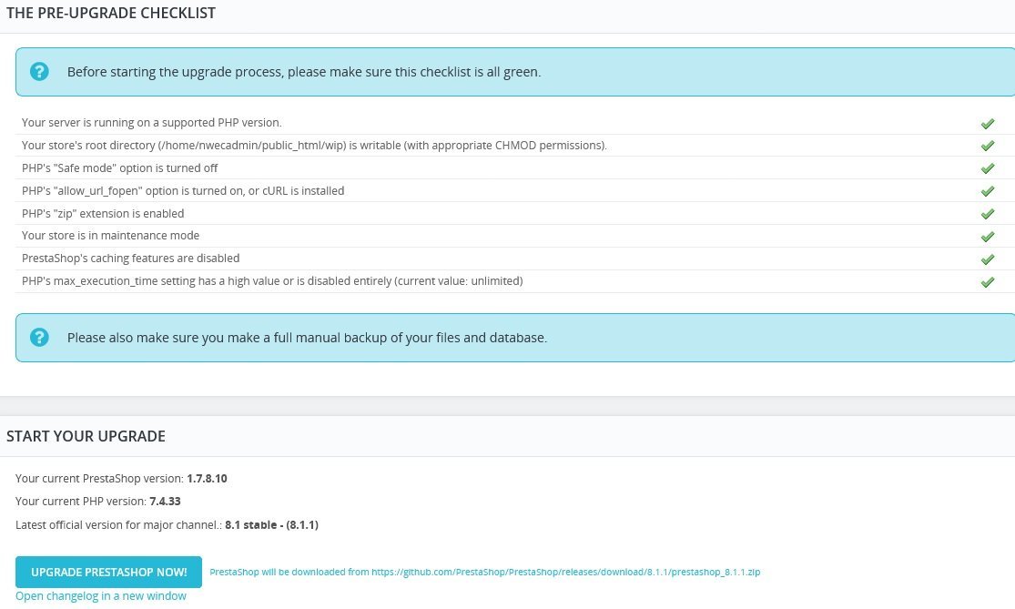

Prior to updaing I have done all available module updates, turned all cache off, cleared cache, uninstalled all non ps modules, switched to classic theme and deleted my custom theme but still showing errors.
The Pre upgrade checklist shows fine

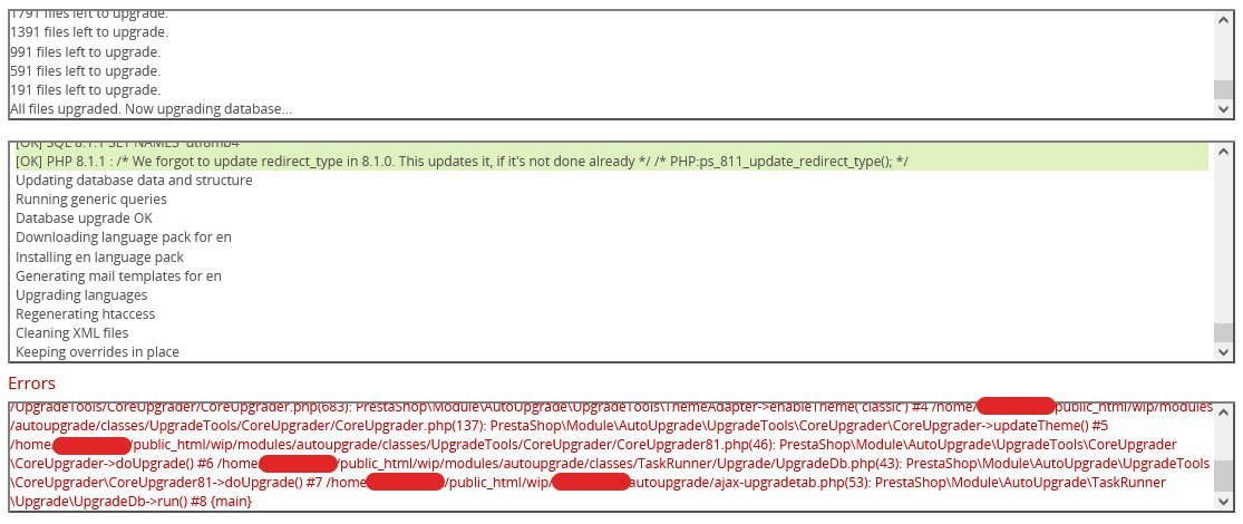

and the activity log shows the following errors
[INTERNAL] /home/xxxxxxxx/public_html/wip/src/Core/Addon/Theme/ThemeManager.php line 398 - PrestaShop\PrestaShop\Core\Domain\Theme\Exception\FailedToEnableThemeModuleException: Unfortunately, the module did not return additional details. #0 /home/xxxxxxxx/public_html/wip/src/Core/Addon/Theme/ThemeManager.php(255): PrestaShop\PrestaShop\Core\Addon\Theme\ThemeManager->doEnableModules(Array) #1 /home/xxxxxxxx/public_html/wip/modules/autoupgrade/classes/UpgradeTools/ThemeAdapter.php(113): PrestaShop\PrestaShop\Core\Addon\Theme\ThemeManager->enable('classic') #2 /home/xxxxxxxx/public_html/wip/modules/autoupgrade/classes/UpgradeTools/ThemeAdapter.php(51): PrestaShop\Module\AutoUpgrade\UpgradeTools\ThemeAdapter->enableTheme17('classic') #3 /home/xxxxxxxx/public_html/wip/modules/autoupgrade/classes/UpgradeTools/CoreUpgrader/CoreUpgrader.php(683): PrestaShop\Module\AutoUpgrade\UpgradeTools\ThemeAdapter->enableTheme('classic') #4 /home/xxxxxxxx/public_html/wip/modules/autoupgrade/classes/UpgradeTools/CoreUpgrader/CoreUpgrader.php(137): PrestaShop\Module\AutoUpgrade\UpgradeTools\CoreUpgrader\CoreUpgrader->updateTheme() #5 /home/xxxxxxxx/public_html/wip/modules/autoupgrade/classes/UpgradeTools/CoreUpgrader/CoreUpgrader81.php(46): PrestaShop\Module\AutoUpgrade\UpgradeTools\CoreUpgrader\CoreUpgrader->doUpgrade() #6 /home/xxxxxxxx/public_html/wip/modules/autoupgrade/classes/TaskRunner/Upgrade/UpgradeDb.php(43): PrestaShop\Module\AutoUpgrade\UpgradeTools\CoreUpgrader\CoreUpgrader81->doUpgrade() #7 /home/xxxxxxxx/public_html/wip/xxxxxxxx/autoupgrade/ajax-upgradetab.php(53): PrestaShop\Module\AutoUpgrade\TaskRunner\Upgrade\UpgradeDb->run() #8 {main}

Hi @MerseyRayIt's problaly not realted to that module.
I just had this problem and fixed it like this:
  1. Restore backup to 1.7.8.10
  2. Go to "Design > Theme & Logo" and select the Classic as the active theme.
  3. Clear the "var/cache" folder (remove the dev & prod folders).
  4. Disable the "Switch to the default theme" option in the 1-Click Upgrade module.
  5. Update it again.
Make sure the "Switch to the default theme" is disabled before you click the upgrade button. sometimes it goes back to enable by itself.

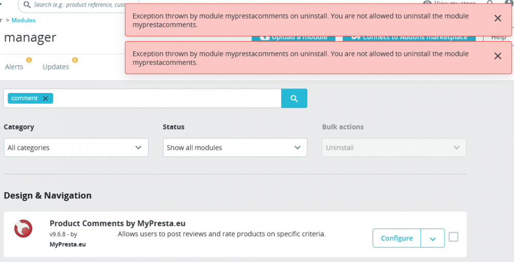

I have tried deleting that folder as the module wont uninstall or reset.
I will be changing it to php8 once the update has done. The current install wont run on php8

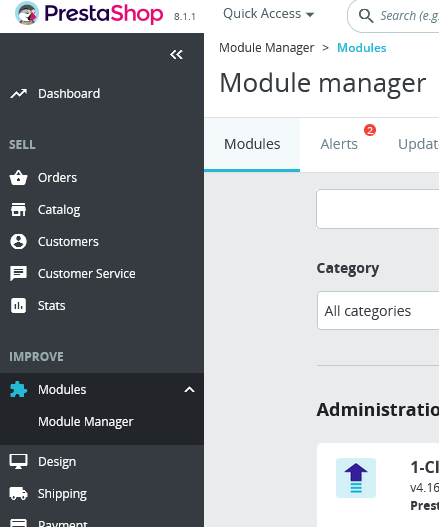

The back office theme is still the old style (I have cleared cache, tried deleting the prod folder again, tried other browsers)
Inspecting the code, the css is still loaded from %adminfolder%/themes/default/css/vendor/nv.d3.css
The new B.O theme should be loaded from https://unpkg.com/@prestashopcorp/edition-reskin@latest/dist/back.min.css

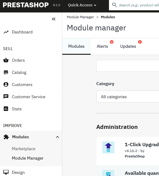

Where as on a clean install on the same server, 8.1.0 looks like this
And as you can see from the images, the "Marketplace" menu item is missing on the updated site, but present on the clean install.

Now if I try and switch the theme to "classic" i get the same error

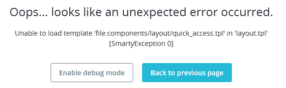

and the Profile/Permissions page shows this error
If I'm not wrong, there are 2 different versions of PrestaShop. One that is called "Edition Basic" and you can download it from prestashop.com/versions
and one that you can download from GitHub
The autoupgrade module downloads the GitHub version and I think that's why your BO looks different. If you install the 8.1.1 version from GitHub, It'll look like your current upgraded shop.
If you want the Edition Basic version, you should probably use the Local directory/archive for the channel mode and upload that file.
Download and install the "ps_mbo" module from this page:
https://github.com/PrestaShopCorp/ps_mbo/releases/tag/v4.5.1
Enable debug mode so we can see the details of the error. If you couldn't figure it out, post a screenshot of it.

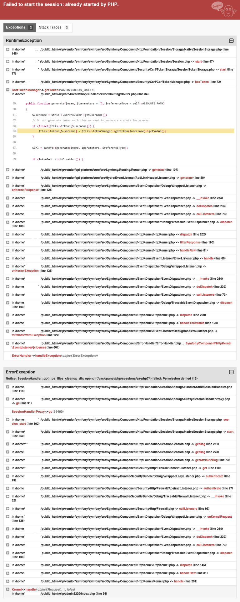

@MerseyRay So the update worked fine without any errors? (I thinks that's the importnat part.)
About the style, I hve no clue. maybe if you copy the admin/themes folder from that balck & white ps, you might get it working on your upgraded site, but I'm not sure if it's the best way to do it. you may find the reason if you search for it.
about the debug, no idea what's the first part. But I had the bottom notice (ps_files_cleanup_dir) before and I fixed it by changing the session.save_path to /tmp in the php.ini file.
It's probably better to start a new topic for the first error.
