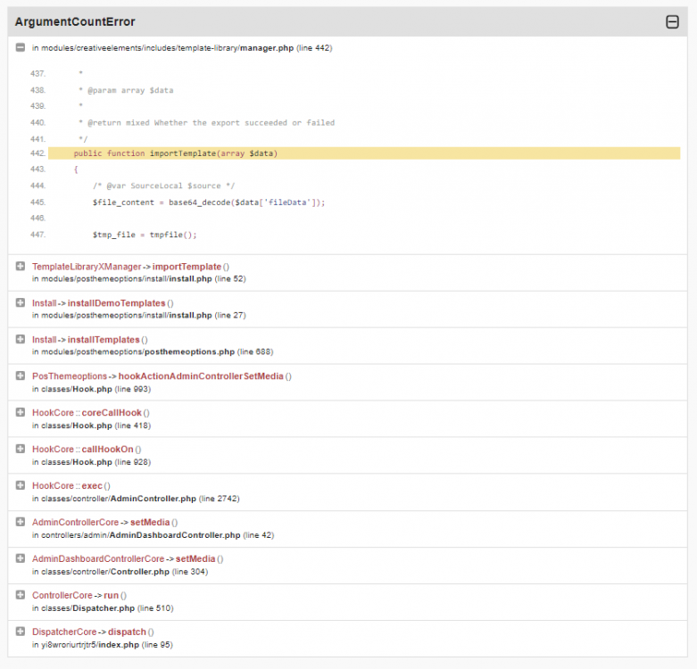

Santietsit Posted August 9, 2023 Share Posted August 9, 2023 Hi all, I am recently new to prestashop, and I have to say that the experience so far has been incredible. Spend some time working on the backoffice, and today I installed a paid theme (Ecolife Elementor), and just after I install it, the whole system crash, and I can't access the backend / frontend is completly frozen. This is the Log that I am getting, hope someone can give me any advice. LevelChannelMessage INFO16:53:01phpUser Deprecated: Since api-platform/core 2.7: The service "ApiPlatform\Core\Bridge\Symfony\Routing\IriConverter" is deprecated, use ApiPlatform\Symfony\Routing\IriConverter instead. { "exception": {} } CRITICAL16:53:01requestUncaught PHP Exception ArgumentCountError: "Too few arguments to function CE\TemplateLibraryXManager::importTemplate(), 0 passed in /homepages/23/d970233196/htdocs/patitas/modules/posthemeoptions/install/install.php on line 52 and exactly 1 expected" at /homepages/23/d970233196/htdocs/patitas/modules/creativeelements/includes/template-library/manager.php line 442 { "exception": {} } INFO16:53:01phpDeprecated: Optional parameter $id_lang declared before required parameter $limit is implicitly treated as a required parameter { "exception": {} } INFO16:53:01phpDeprecated: Optional parameter $id_lang declared before required parameter $tag_list is implicitly treated as a required parameter { "exception": {} } CRITICAL16:53:01phpUncaught Error: Too few arguments to function CE\TemplateLibraryXManager::importTemplate(), 0 passed in /homepages/23/d970233196/htdocs/patitas/modules/posthemeoptions/install/install.php on line 52 and exactly 1 expected { "exception": {} } DEBUG16:53:01doctrineSELECT t0.id_lang AS id_lang_1, t0.name AS name_2, t0.active AS active_3, t0.iso_code AS iso_code_4, t0.language_code AS language_code_5, t0.locale AS locale_6, t0.date_format_lite AS date_format_lite_7, t0.date_format_full AS date_format_full_8, t0.is_rtl AS is_rtl_9 FROM pat_lang t0 WHERE t0.id_lang = ? [ 2 ] Link to comment Share on other sites More sharing options...
endriu107 Posted August 9, 2023 Share Posted August 9, 2023 Remove those modules from server: posthemeoptions and creativeelements After that you should have access to BO, you also should contact with theme developer. 1 Link to comment Share on other sites More sharing options...
