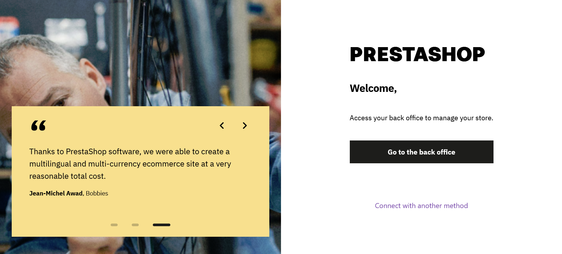

EcoPets Posted August 9, 2023 Share Posted August 9, 2023 I JUST used 1 Click Upgrade to go from 8.1.0 to 8.1.1. There were no errors in the upgrade process, but now whne I try to login to the back office I get this error: Attempted to load trait "PrestaShopLoginTrait" from namespace "PrestaShop\Module\PsAccounts\Provider\OAuth2". Did you forget a "use" statement for another namespace? [Symfony\Component\ErrorHandler\Error\ClassNotFoundError 0] So I am locked out until someone can help figure this out. I can do a full site restore but would rather not. The site seems to be fine on the front end Link to comment Share on other sites More sharing options...

EcoPets Posted August 9, 2023 Author Share Posted August 9, 2023 Thanks, but I cleared the cache and it made no difference. I think it would be nearly impossible to compare the files from 2 different versions, but I appreciate the suggestion! What I think happened was the upgrade messed up the database, but I don't know how to easily fix that. When I look at the database table in phpmyadmin, there are twice as many and half have the prefix , ps_, from the original 8.1.0 install and then there are duplicate that have no prefix, like psaccess vs ps_access. This part of the error above, "Module\PsAccounts\", kind of gave me that clue and I looked at some of the tables that had data from before the upgrade, tables with the ps_ prefix, and those without the prefix did not have that data. Alas, I did not have a database back up, so I cant restore that. What I am doing is purging the tables without the ps_ prefix and see if that cleans things up. Last resort would be a reinstall of 8.10 from scratch and then import the database back from the server backups. If it means anything , this error only occurs on the back office accessed from the attached page. If I click on the "connect with another method" and get to the usual back office login, I then get the error that the password or account details are wrong. If I try to reset the password, the email comes but the link does nothing. I tried resetting the password in phpmyadmin, but that does not correct either problem. Link to comment Share on other sites More sharing options...

futurehousestore Posted February 25 Share Posted February 25 In order to log in normally to your website, you must choose the option of "Connect with another method" on the new login start screen. Link to comment Share on other sites More sharing options...
