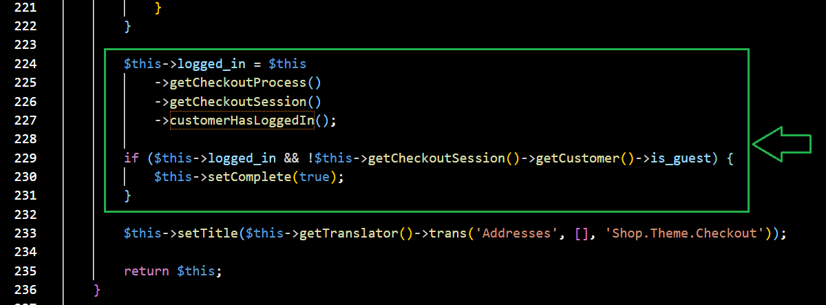

ps8modules Posted July 13, 2023 Share Posted July 13, 2023 (edited) Hi. For Prestashop 1.7 ./classes/checkout/CheckoutAddressesStep.php 1. find function handleRequest 2. almost finally add functions $this->logged_in = $this ->getCheckoutProcess() ->getCheckoutSession() ->customerHasLoggedIn(); if ($this->logged_in && !$this->getCheckoutSession()->getCustomer()->is_guest) { $this->setComplete(true); } 3. result: Edited July 13, 2023 by ps8moduly.cz (see edit history) Link to comment Share on other sites More sharing options...
lcsh Posted July 14, 2023 Author Share Posted July 14, 2023 Thank you for your answer ! 🤩 It work only when it is the second time i'm coming on a cart. The first time i see a new cart it go to address step. I dont see any particular error in the console. Do u have tested it ? maybe it come from my site, it is a bit customized and wobbly sometimes. Im on 1.7.8.9 btw. Link to comment Share on other sites More sharing options...

lcsh Posted August 10, 2023 Author Share Posted August 10, 2023 (edited) I lied, it doesn't work, sorry for the spam. So if somebody (a real person) could help, it would be really appreciated. Ok, Thanks to ChatGPT (yeah its real), i've found a solution. After discussing with him about the ps8moduly.cz 's code, and after he tell me that i should do it with override(i know), he tell me that the main reason for this error should be "Session Initialization : the session might not be fully initialized or updated during the very first visit to a new cart. This could potentially affect the behavior of the code". So i asked him how to repair that. He tell me to add this below code before the ps8moduly.cz 's code : // Make sure the session is started and initialized if (session_status() !== PHP_SESSION_ACTIVE) { session_start(); } And it work. (I'm still testing every checkout process, but i've seen no problem for now.) So thanks to ChatGPT and @ps8moduly.cz, this thread is [SOLVED], thanks ! Edited August 10, 2023 by lcsh i lied (see edit history) Link to comment Share on other sites More sharing options...
